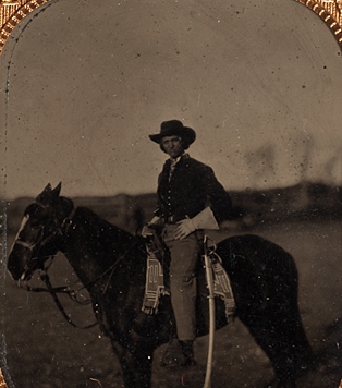

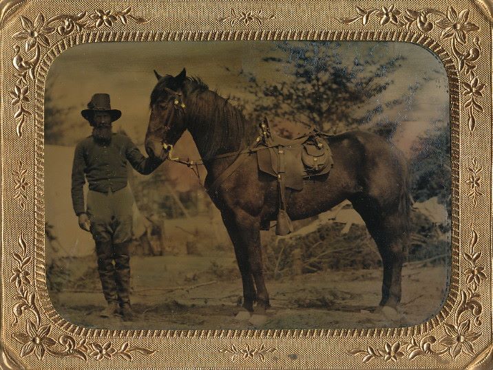

    1. Breast Collars: Nothing marks a mainstream cav trooper quicker than the brass heart breast collar. Or almost any breast collar for that reason. There has been a great amount of research and many threads on this subject to support that breast collars were not standard issue nor NUG for the rank and file. But exactly how common were breast collars? Attached are two controversial pics that have been used to support the use of breast collars.
Name:	breast collar.jpg
Name:	breast collar3.jpg
Name:	breast collar4.jpg

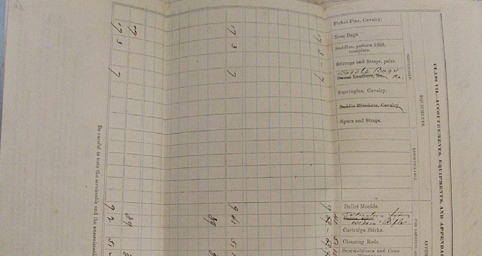

    While there is documented proof of cav troopers using breast collars, the first hand proof that we generally deem them as inaccurate is the previously stated fact that they were not a standard issue item. While cruppers came with the "standard" set of tack, collars did not. Below are some examples of documented tack being issued to the 11th Ohio Cavalry and is listed as the standard "Complete Saddles" listing.

      Always a good topic to think about, and I appreciate the inclusion of photographic or other evidence in the discussion as it takes us out of the realm of "I think" into "I can show you."
      You make a clarification in your opening about heart breast collars, and that is an important distinction in the conversation. None of the photos you shared featured the brass heart collar. Of the photos you shared it looks like the first guy in the grey has used a surcingle as a breast collar while the other ones have what appears to be purpose made leather breast straps. Having a civilian/custom made/surcingle breast collar is totally appropriate in some measure in the ranks, what isn't cool are those nearly universal (among mainstreamers) brass heart collars.

        In the past did some work on the 8th Illinois Cavalry. I used ordinance returns, a set of requisitions from the regiment's quartermaster in the Lincoln Library , diaries etc

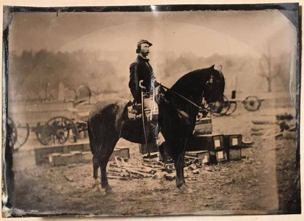

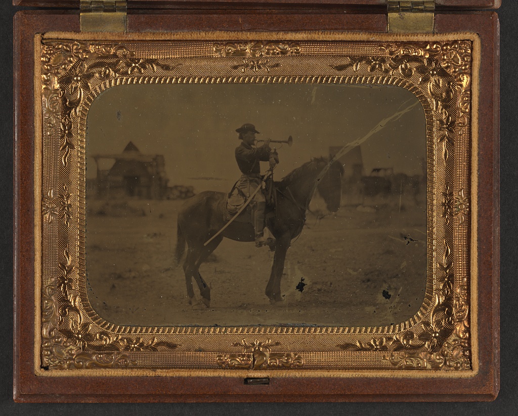

          Great reiteration of the difference between the brass heart collar vs. other kinds. The reason I used those pictures is because i have been given those in reference to prove that breast collars are authentic. However, like you said, the devil is in the details, while a number of collars in general could be considered authentic, the wide use of the brass heart collars we so commonly see at events definitely is not NUG.
          Another common thing I have been thinking about is the "over-use" of the standard civil war cav bridle. In many of the available pictures of tacked horses, many of them have civilian or otherwise non-issue headstall/bridle. See pictures Below:

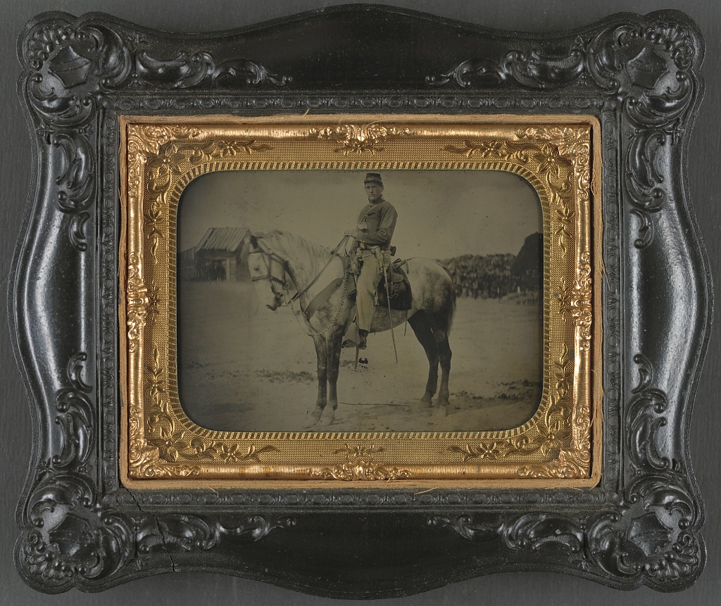

          It seems that at least martingales (at least) are under-represented in reenacting today. Of course it must be noted that many of the pictures that have enough detail to see what kind of bridle is being used are officers, Jr. Officers, or in some cases NCO's. Definitely not a good representation of the standard rank and file. Below are some other pictures of other troopers with a bridle more similar to the standard issue one:
          Either way, it is worth considering the use of non-issue bridles/head stalls on the federal side of things.
