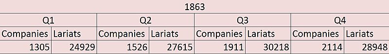

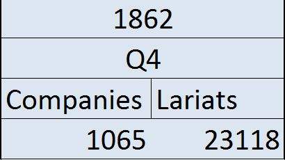

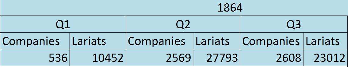

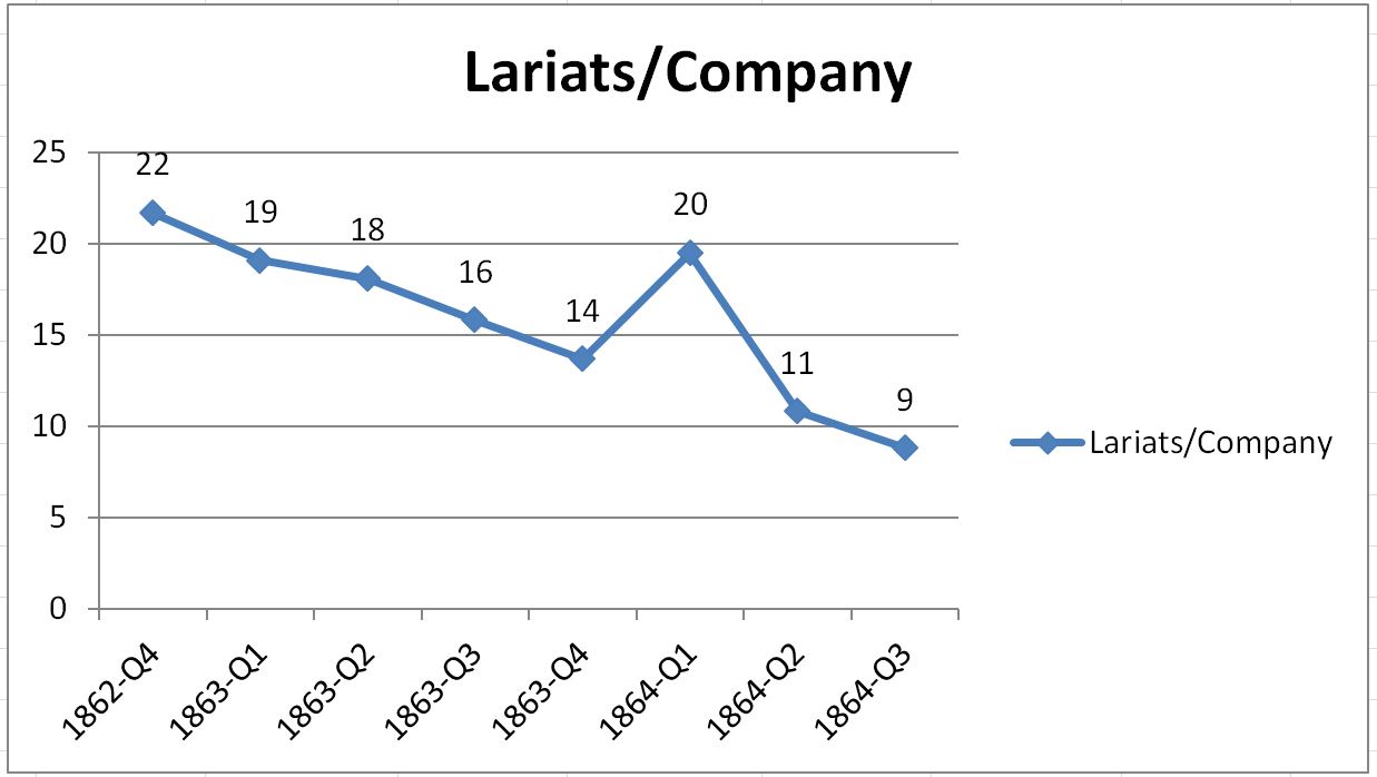

However, something interesting occurred in the records starting in the first quarter of 1864. The numbers of picket pins drops dramatically while the numbers of lariats remained at the same rate. Another common trend was that the vast majority of regiments were “in the field” from this point on in the war. Another thing to note on reporting locations is that the cavalry regiments who were not in the field rarely had pins or lariats issued while regiments in the field had almost enough lariats for the number of men that were “fit for duty” in that specific regiment. Therefore, the federal cavalry must have used the pin and lariat in the first half of the war in a more traditional sense in how it was meant to be used. However, the pin seems to be disposed of for many troopers in the last campaigns of the war.

After becoming a living historian and using 100% quality 4 strand Hemp rope (as per the Ordnance Department specifications), I noticed a peculiar trend in these ropes. It only takes a few uses to get wet, rotten, and deteriorated to a point that causes it to break with the slightest tug by the horse. We personally experienced this on our last campaign where we were using rope that had been through 5-6 previous muddy events. Our horses kept popping the rope and breaking it throughout the night causing loose horses and a busy shift for the night watches.
We quickly realized that the lariats were really only good for about a month of actual use. After which it would break easily. The quicker they break, the harder it would be for the QM to keep up with reissuing new ones. My Hypothesis was that the numbers of Lariats would progressively decrease as the war went on. As you can see in the data below, a clear trend appeared once we plugged every single company of cavalry that turned in their quarterly numbers.
