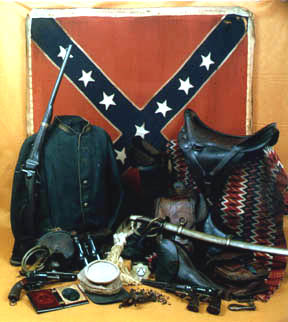

                            Although you can't tell much from this image, here's the picture from Confederate Memorial Hall's web site showing the saddle that Larry refers to in his above post.
                            A cursory glance at this image and the images that Neill referenced seems to support Larry's thesis.
                            (Larry, call me if you don't understand "thesis";) )

                              Mike,
                              That's the saddle. Unfortunately, the pic isn't very clear so it's hard to see any of the details. What struck me as odd about the CMH saddle is the size in proportion to everything around it. In the pic that you provided, if you'll look at the sabre lying next to it, you can see the distance of the length of the hilt is nearly half as long as the saddle itself.
