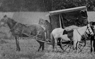

    I am hoping someone here might be able to offer some advice on acquiring correct harness for an ambulance I am working on. Pattern, hardware, maybe someone who would even like to make it.

    This appears to be a common light driving harness with the addition of an extra shaft carrier on the britching most likely to help with the extra weight of the wounded passangers. I have never found a spec for ambulance harnnes in this era. As ambulances were fairly new and the arsenals were busy with artillery harness this is very likely an off the shelf purchase

      that's a great picture and one I haven't seen before. Not to change the subject but there's a good view of a period civilian saddle that several people here have inquired about before. Can you get a better close-up of that saddle? It could add to our edification! Thanks,

        Thanks for the input. Any suggestions on where to go for this rig?
        Here is an enlargement of the saddle you asked about. From the picture, it is very similar to the saddle I use for RevWar.

          That looks very similar to many civilian flat or english saddles of the period. I had posted a diagram for the saddle to be used from an 1834 manual and what is thought to be the 1833 Dragoon saddle. Here is a link to an article from the Military Horse about it with links to diagrams from the manual.
          http://militaryhorse.org/articles/holmes/1834manual.asp
          The point being, this style of saddle has origins well before the American Revolution and survives to this day. Quite an amazing piece of horse equipment.
          By the way...check out these photos of the actual "mystery" saddle. Note the closeup showing the underskirt...ie. leather top, heavy cloth lining, vertical quilting...very common pad throughout th 19th. century.
          http://militaryhorse.org/articles/holmes/mystery.asp
          Good luck with your project...you can never have enough horse drawn anything! I'd really love to see wagons being pulled by mules on a jerk line hitch with one driver on the near wheel horse...now that would be something!

            Correct me if I am wrong (I am getting really bad resolution off the photo) but it appears to be a variation on a hame type harness instead of a light driving harness.
            To me it appears that the tugs are running to a collar and not a chest piece. The hold back on the britching does have an extra piece that appears to be there to help with weight. (the whole rig looks like it should have a mark that says you need to be this tall to ride :D )
            If you live anywhere in the NY, PA, OH area, I am sure any amish harness maker could reproduce this harness given photos and enough information, but you will probably have to look elseware for the correct hardware.

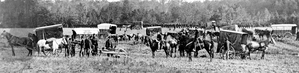

                Here is the entire image . . . The image is from May of '63 . . .

                  It looks like it employs a collar to me. Definetly not what I consider a light driving harness.

                    Definetly collar and hames. To me a light driving harness from the apperance of the size of the straps. The gig saddle is not clear so most of the padded types with patent covers would not do. Dover books has published a few reprints of 19th and early 20th century harness and tack you might get some ideas for hardware from them. The gray, in harness, appears to have checks probably a head tosser

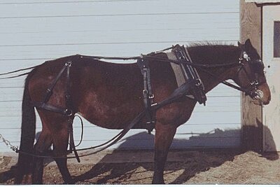

                            Dear Friends,
                            Thank you for all your advice.

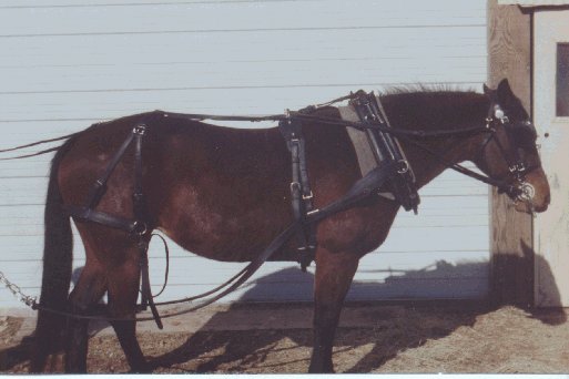

                            A vendor has suggested this rig. What do you think? It certainly resembles the ones pictured in the NA photo. The maker uses Herman Harness Leather.

                              Just curious,
                              Can they change out the chrome hardware and add the double strap that appears to assist with the added weight on the fills.
                              There also appears to be some significant differences in the bridle.
                              Coupled with the photos, it could be a starting point to build from, if photos are the only refernce material available.
