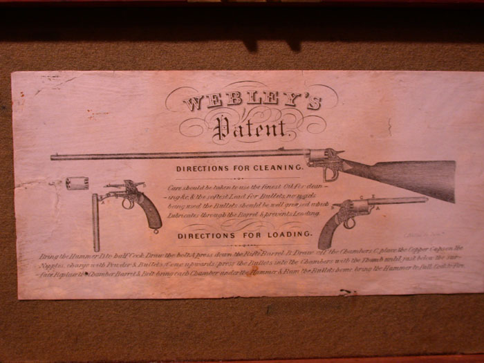

                  In the private purchase arena, each revolver came with instructions from the manufacturer. Below are thumbnails of examples. I found these online, and the website of Peter Dyson has the Colt instructions in the "gun labels" section.
                  Mark Latham
                  Mark Latham
