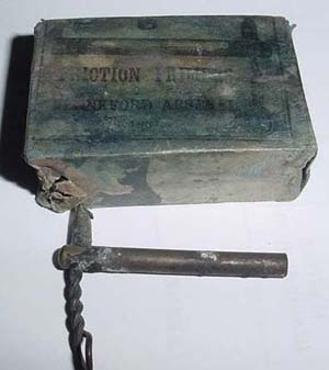

          This one is open, and an investment in an original with long-term benefit if you wish to reproduce them. http://www.regimentalheadquarters.co...iction-primers

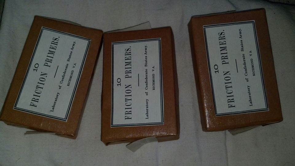

                  I thought I might update this thread with some of the replicas I have have made. They are fully functional and we use them at events. Click image for larger version

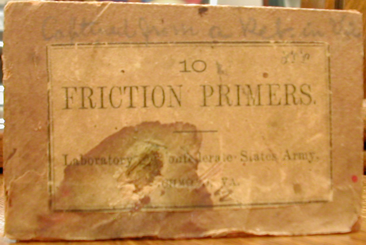

                  The original
                  David H. Thomas
