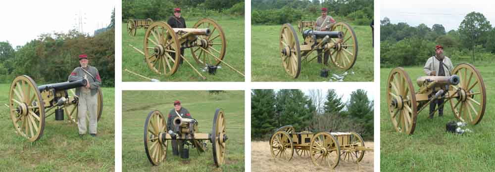

    here is a picture of the cassion we built for the Hunley crew funeral in Charleston SC and a few of our guns, let me tell ya the shine on that 12 pdr field howitser will fry yer retinas!:D
    Gary Mitchell
    2nd Va. Cavalry Co. C
    Stuart's horse artillery
