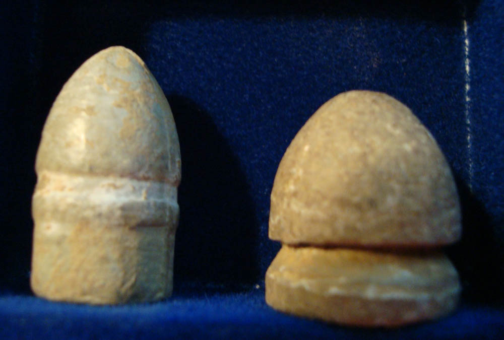

                    Shotgun cartridges were issued in various configurations (balls and slugs). Here is a slug round found in a CS cav. camp near Stoney Creek. I have a sharps bullet left of it for size comparison.

                      Jim,
                      That slug is a heck of a piece of lead sitting next to that sharps bullet. Do you know what the recommended amount of black powder was for that monster??

                        That slug looks like it could do some damage to the poor unfortunate person who is hit by it!
                          Sorry I don't but I suppose it is in one of Dean Thomas' Roundball to Rimfire books. I have the first volume and it doesn't say much about shotguns.
