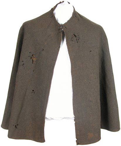

                      Good point! I didnt realize that the cape was not with the original. Perhaps we have hit on something. It seems that it was common to line removable capes. See this one for example:
                      WORN AT BATTLE OF SHILOH BY LIEUT JAMES P BOWMAN120. [CONFEDERATE OFFICER'S CAPE] Gray cape worn during the Civil War b
                      Also, the officer's cape on Chris Daley's page has a semi lining (at least in the shoulders).
                      Again, no evidence to support lining a federal overcoat with branch of service color.
