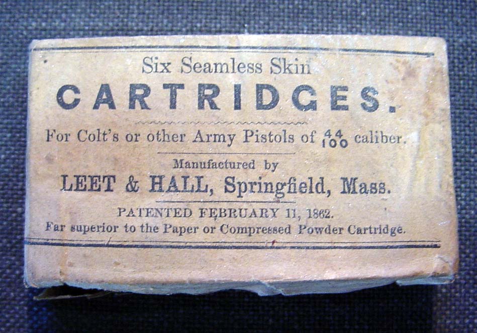

        No caps in this box. Only six bullets. This one came from a batch of around 15 boxes like this one in Cal 32 and 44. None had caps included. There was a small tin of caps. Leaves me to wonder why more small tins are not dug often if they were issued as such.

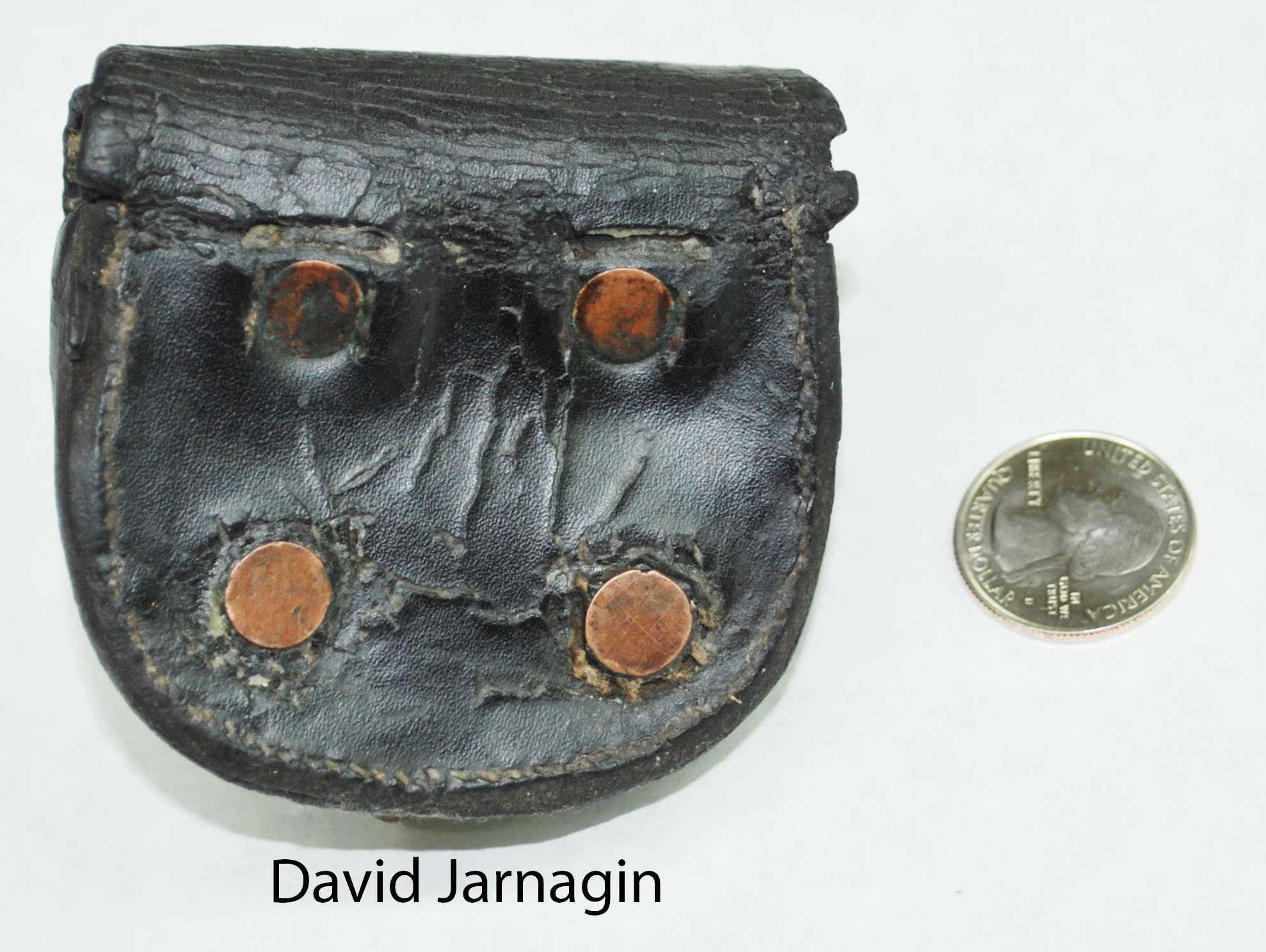

                      Not to throw a monkey wrench in the works but there were pistol cap pouches made as you can see from attachmentClick image for larger version
Name:	pistol cap pouches.jpg
ID:	225149. I have seen one original but I do not know how many states made them.
                      David Jarnagin
                        Re: Cavalry equipment question - percussion caps
                        Any images? How do they vary from a traditional cap pouch?

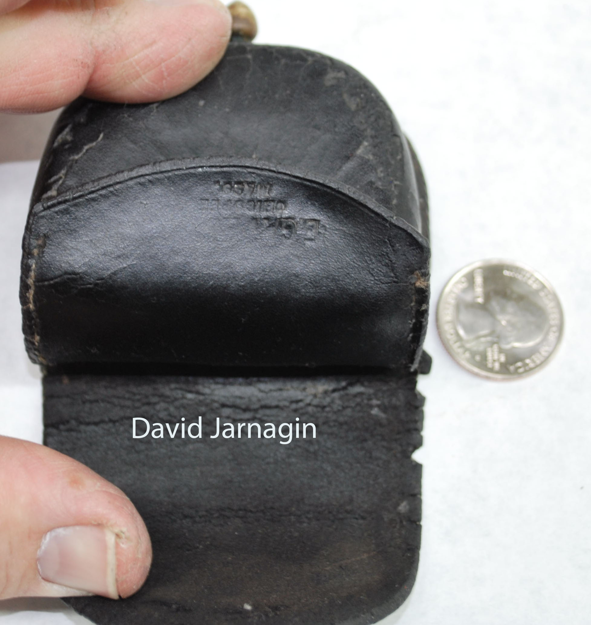

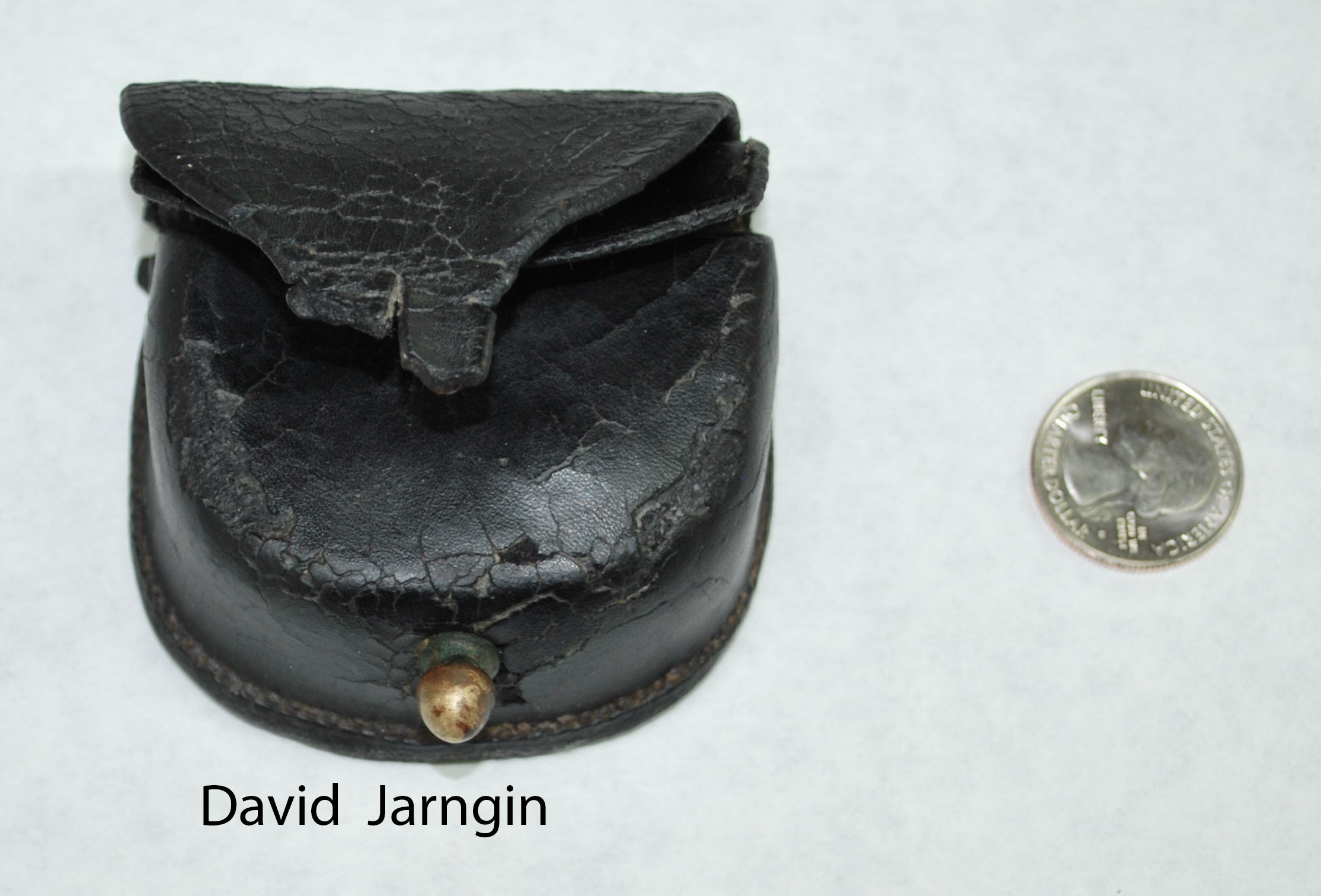

                              Here are a couple of images. This one was made by Gaylord and the quarter is in the picture for size reference.
                              The Danish exchange pictures are of regular cap pouches. The first one is on an infantry waist belt and the second is on an Artillery sword belt. These are arsenal made cap pouches.
                              David Jarnagin
