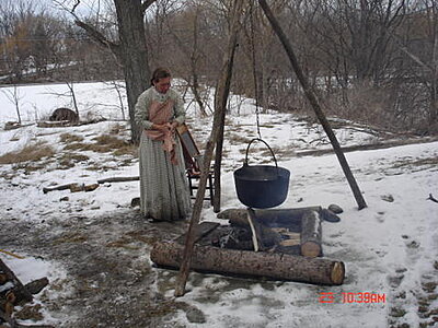

    Hog scalders or salt kettles are about the only things big enough to do this job. The type of washpots commonly available, about a #18, won't do this job--the fabric is too crowded to have a snowball's chance of dyeing evenly.
    The wash kettle utilized at the 2008 Winter 64 in Newfane, New York, pictured below, is marginally capable of doing the job---one coat at a time. Having once transported 100 gallons of stinky oozy gooey black walnut dye in the back of my brand new mini-van, I know the hazards of such an undertaking, and will not be volunteering to haul dye up there.:tounge_sm
