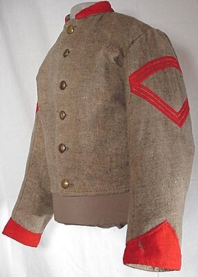

                              Hi,
                              I certainly wouldn't part with any of my money for the jacket - especially after Bob McDonald appears to have delivered the 'death blow'! However, whilst I would agree it does have the farby 'Gone with the Wind' look to it I wouldn't necessarily use that to dismiss the jacket at first glance. I've attached a couple of pictures, the first is a jacket from a reputable dealer (Old South Military Antiques, examined by Les Jensen - discussed at length in a previous thread), the second a period photo.
                              Regards
                              Paul Jonsson (England, UK)
