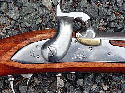

      Here is an example of a CS "brazed breech" conversion (if I am understanding that process correctly) of a pre-1816 musket.
      and another...

          John, thanks for posting those, all of mine are on my computer at work and with the snow I am at home. There are several other variants but most, if not all were done by contractors in Richmond and Lynchburg as I said above. For more examples and more information see:
          type "Virginia Manufactory of Arms" into search. You will get pages of information and will be able to see both original flint and percussion conversion arms.

                  Re: Todd Watts Cone-in-Barrel Flintlock Conversion
                  Thanks for the pictures, but that one is not mine.
                  (Mine did not have a "bolster" type area, it just the NUG "bump" on the barrel. And the lock and barrel markings are different.)

                    Originally posted by rbrewer View Post
                    I've tried the search feature with no luck. I would appreciate anyone describing how parts were brazed in the 1860's.
                    Also, when can we see photo's of the Todd Watts conversion?
                    Many thanks!!
                    Bob Brewer
                    Gaithersburg,MD
                    Parts were brazed using (what else?) heat. A forge stoked with charcoal would have been the best, cleanest source of heat. The barrel would not need to have been covered with charcoal, it and the bolster would have been aligned correctly and clamped in position and held above the heat source until the brass braze flowed. It was then removed, checked for soundness and cleaned up with final shaping and drilling done as finish up. The addition of a precisely located bolster would have been difficult but they knew how to do it and did it well.
