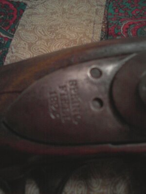

        Reference photos of my 1822, if anyone is interested. Not bragging, just wanting to put the pictures out there in case anyone was interested.

          Re: M1816/1822 cone threading
          I'm curious: are there any traces of rifling in the barrel?
          Jim
          James Brenner
            Nope. A bore light reveals traces of the barrel seam, but no rifling.
            Bob Welch
            The Eagle and The Journal
              Thanks. The Ohio surcharge made me wonder if it was one of those elusive Greenwood muskets.
