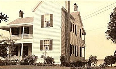

    The home I grew up in has been a work in progress for about 150 years.
    The orginal first floor front rooms are mortise and tenon.
    The new kitchen addition in the back dates to the 1920's. I've seen it all.
    My folks used Aldelphi Paper products.
