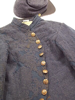

It is also very similar to the Alfred May jacket [61st NCT] which is of BG Kersey but has belt loops. This jacket was originally 6 button but 5 extra buttonholes were added later. Les Jensen and Ben Tart believe this to be a NC pattern although the 61st did see some service around Charleston. These photos are from the NC Museum of History in Raleigh. More pictures can be found under 'artifacts' on the website, keyword(s) "Confederate jacket."Bob Williams

I don't see the Charleston style collar.
Also the description lists it as a 4 piece body and a 6 piece body at different times. The pictures don't show whether or not there is a seam under the arms, but clearly the seams to the sides of the back suggest either a six piece body or the false six piece bodies that lack the seams under the arms.Pat Brown
Re: Original "Charleston Depot" Jacket For Sale
Good observation. The problem is that the jacket was so badly deteriorated on one particular part of the collar, there was no way to know what it looked like originally. (And, as fate would have it, that was the same side that could have been used to compare with Jensen's so-called "Charleston Depot" pattern.) What you are looking at is the NCMOH's reconstruction of the jacket to the best of their abilities. Apparently they did not feel comfortable giving it a "Charleston Depot" (per Jensen) collar, although IMHO they did a fantastic job with it. When I first saw it years ago, it was in pretty poor shape.Rich Croxton

Since Roundshot brought up the May jacket thought I'd post a few that I took while looking at the jacket. You can plainly see that it is a 3 piece body, 2 front panels and 1 back panel. There is no seam down the center of the back panel. Sleeves are each a 1 piece sleeve.
As for the restoration of the collar you can see the diff in the original cloth and the restorers cloth.
The 3rd pic is an interior pocket.
The belt loops were just 2 pieces each sewn together then sewn on the jacket w/raw edges exposed.
The last pic shows good detail of the ther difference in button hole stitching which supports the case that they were done at separate times by different people. All 11 of the buttons are original CSA buttons with correct backmarks but the maker escapes me and I cannot make it out on my pic.
