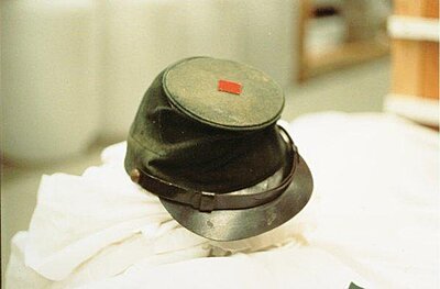

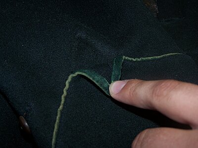

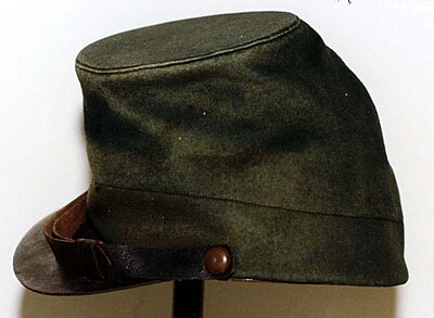

          The original trousers Hank mentions are interesting, and the fading pattern reminds me of some notable Federal uniforms. The facing cloth used to make caps for the U.S. Sharpshooters was originally yellow (possibly surplus stock from pre-war Engineer uniform coat facings) and was sent to Horstmann Bros. for a blue top-dye. Whatever dye they used doesn't appear to have been color-fast since the majority of original sharpshooter forage caps show irregular fading that gives the headgear a "yellowing" appearance. Schuylkill Arsenal also sent indigo dyed uniform coat cloth to Horstmann Bros. to be yellow top-dyed for the frock coats and trousers; although there are no known pair of issued dark green sharpshooter trousers extant, two original issue and field-used uniform coats are a rich dark green color and show no signs of the dye fading or "sloughing" off of the fiber surface. The trim used for these coats ran the gamut from dark grass green to bright emerald but like the forage caps, it too faded and now have a yellowish pea-soup color.

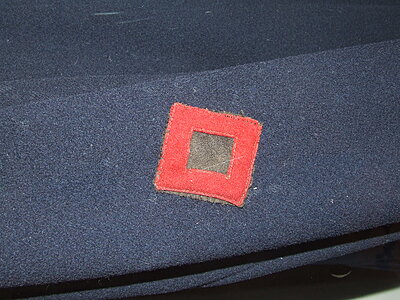

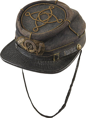

          Below are some photographs that show fading in original Federal uniforms. The sharpshooter frock cuff trim is from the Sgt. William Tilson coat in the collection of Don Troiani. The artillery orderly sergeant's lozenge is sewn to a piece of what I believe is logwood dyed broadcloth; this is from a private purchase uniform coat in the Ross County Historical Society. The forage caps include the "Gettysburg" sharpshooter cap from the Gettysburg National Battlefield Museum; one of two "sealed pattern" examples made by George Hoff of Philadelphia, housed in the Smithsonian; and Sgt. John Schermerhorn's forage cap from the Milwaukee Public Museum. The 12th New York Infantry officer's kepi was worn in 1862 and is a great example of poorly dyed fabric; the soutache and insignia field were likely originally black while the body of the kepi is irregular with an almost purple hue. This final photo comes courtesy of Heritage Auctions.
