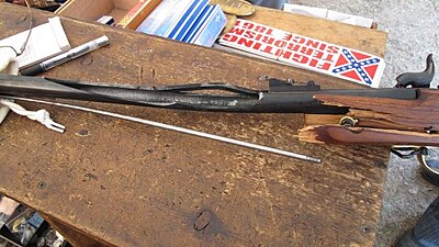

    I figured it would apply more to people on the other forum so I posted it there as well, but thought you all would be interested. A colleague sent me these photos (attached). This occured on the second shot ever fired from this weapon.

    I was not aware of any fireable Indian made muskets. What brand is this? It looks like it actually sent a piece of barrel flying as shrapnel.

        While I am "on record' as being of the more vocal opponents of these Indian made wall-hangers and fireplace decorators being sold and used as firearms... in brief and to over-generalize lads who are not fmailiar with firearms and forearm construction tend to be the lads who choose to use these things feeling them safe for blank and well as live firing.
        That "partisan" discussion aside...

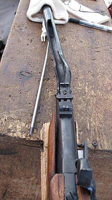

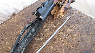

        At first glance, the second image shows a "classic" obstructed barrel "catastrophic failure." A barrel obstruction, most likely, probably, a short-rammed ball, saw a build up pressure right behind it (in fornt of the sight where the barrel has bulged and the inner wall darkened. When the force of the charge reaches an obstruction, if the obstruction does not ge tmoved, the pressure goes sideways making a tell-tale
        "ring." If the obstruction does not yield in time, the "ring" bulges the barrel and bursts it. The hardness of the steel, and the way the "barrel" is made NUG sees it splinter like a cartoon gun.
        Over the years, I have seen or examined a dozen or more muzzleloading barrels burst in the same way by the catastropic failure caused by a short-rammed round or obstruction. There are also about half a dozen on display at my local BP shop. They are a mix of Italian and Spanish made barrels.

                            The thing about this that I don't understand is that you can shoot black powder out of PVC pipe with no problems as long as nothing creates to much back pressure (obstruction in the bore/shooting it live, I've been told you can even shoot it live out of the plastic pipe). The thing I don't understand is why if we can shoot BP through plastic pipe, then why can't we shoot it through a metal tube? Maybe someone could help me understand this. We should be only shooting powder through these things anyway.
                            I have a friend that has one of these type Enfields. I watched him double check to make sure it was good (before the event was started and AWAY from everyone else in line). We put triple the amount of powder called for down the barrel capped it and he pulled the trigger with no problems. He said the company that he got it from proofed them as well and it sure looks like they did as I was skeptical to say the least. I have another pard with the same musket. No problems. It would be interesting to know they why's and wherefores of this rifle blowing apart like this.

                              Triple loading a weak weapon to check for it's strength is like tossing a match in a puddle to see if it's gas.
