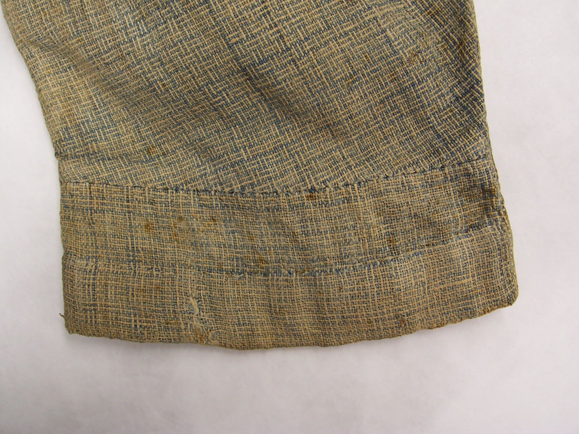

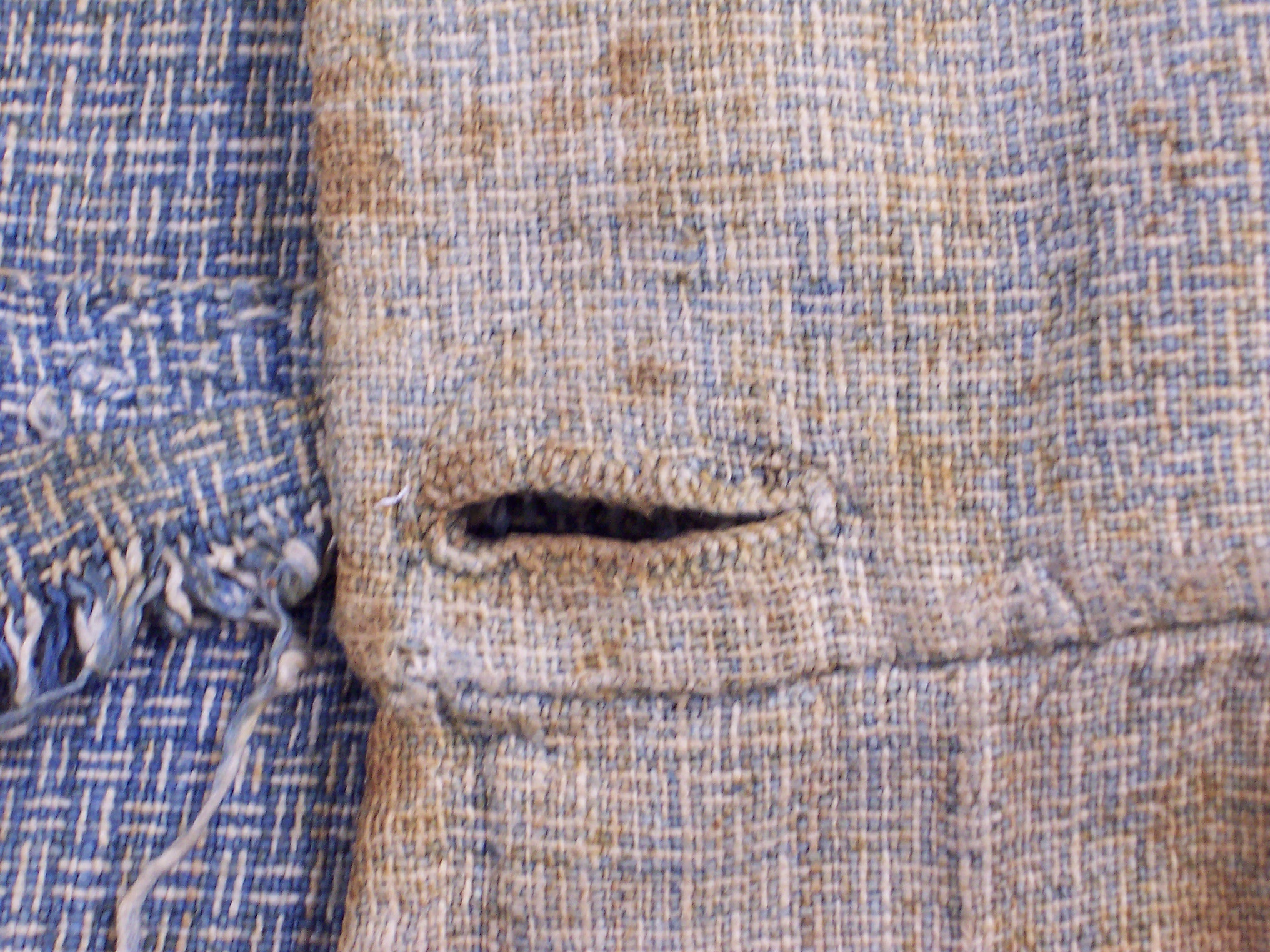

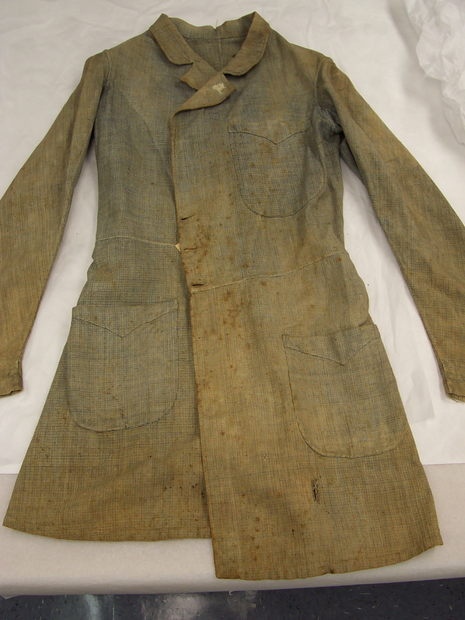

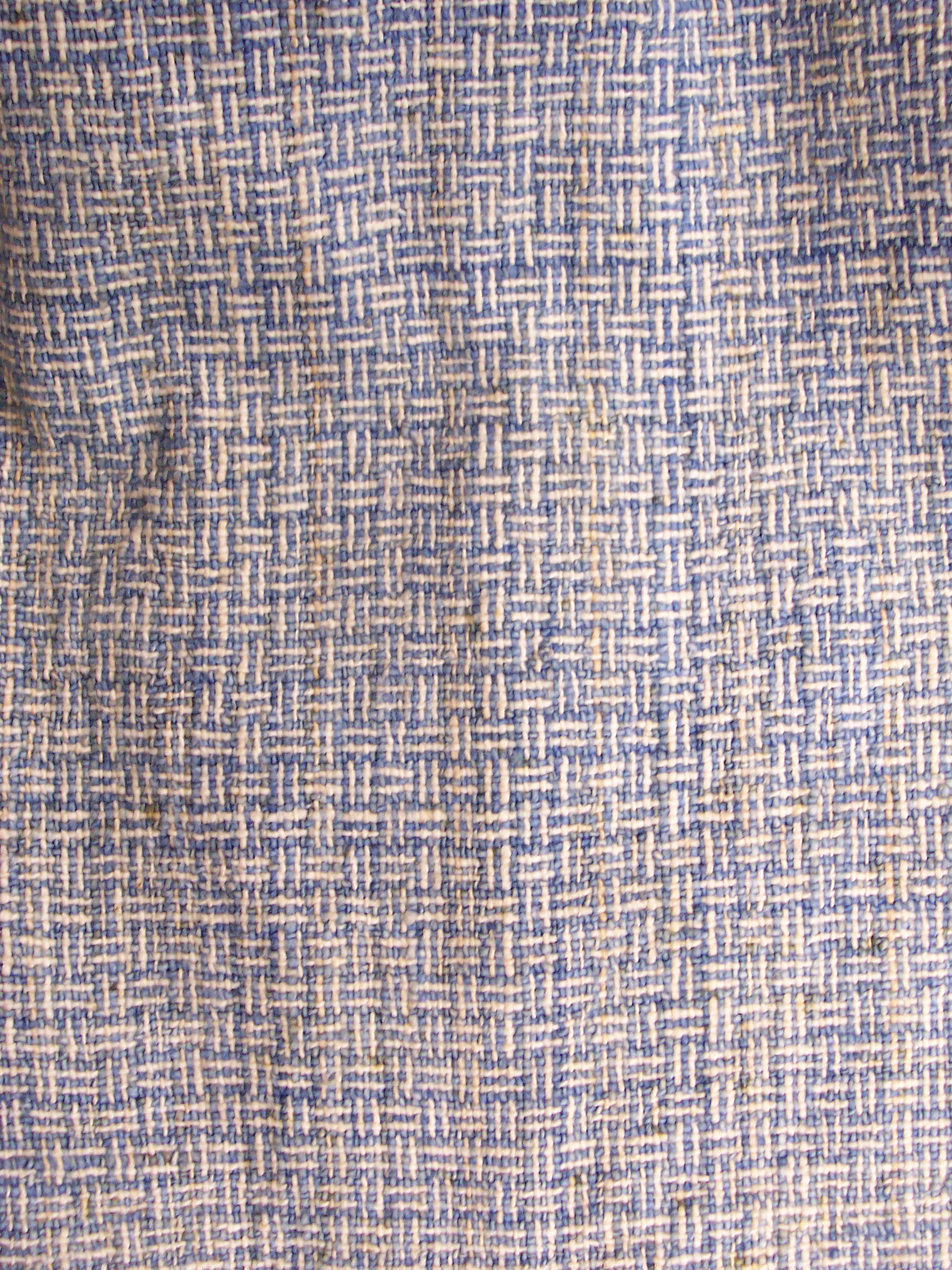

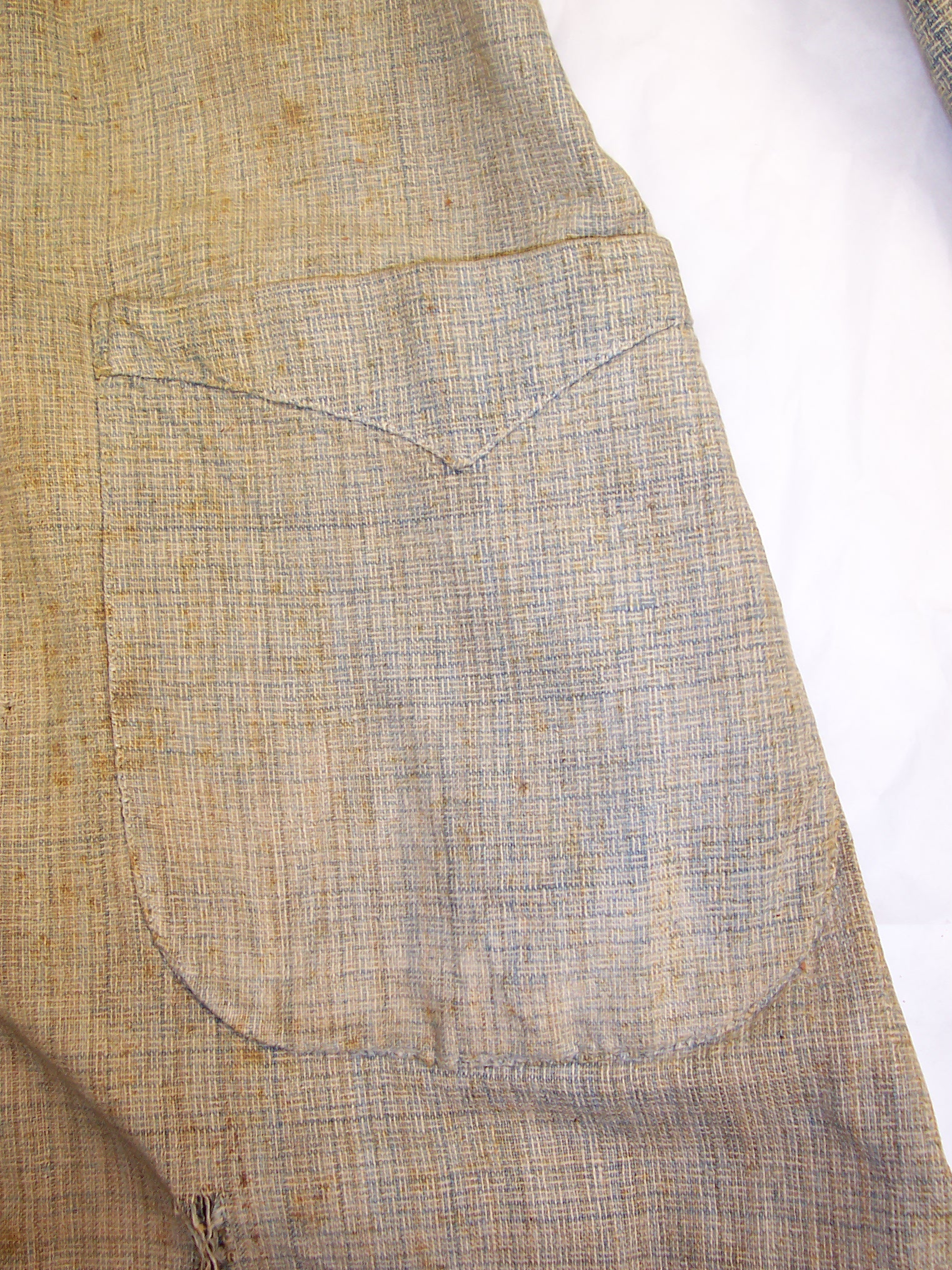

Greetings folks,
While not jeans but rather a cotton/cotton textile, this is the Stevenson civilian frock coat housed at the SCCRR&MM. Provenance with the coat states that the cotton was grown, spun and woven on the Stevenson plantation in Feasterville, SC, and that the garment was worn during wartime by old man Stevenson....his son by the way served as a Captain in the 6th SCVI.
Anyway, unlined with horn buttons and obviously patterned after the owner's tastes. Enjoy!
Neill Rose
Palmetto Guards
Iron SCouts
