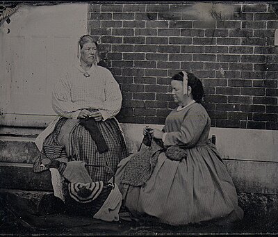

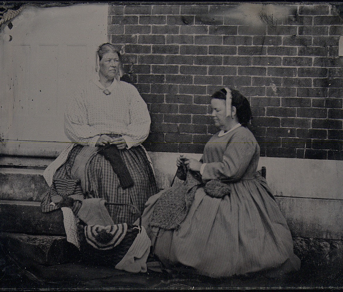

      While we are waiting for the charts to come up, here are some examples of known items. This image was taken at Shaker Village in 2004, Mrs. Willis, AKA "Sister" is on the left, and I am on the right.
      Mrs. Willis is wearing a light blue dress with a black swirl figure and a red center to the figure (showing up as little squares). Her collar and cuffs are white. Her hair is blond. The striped ribbon on her headpiece is shades of pastel. Her apron is black and taupe plaid. Socks on the right, in her hands are red, socks on the left are medium blue.
      The striped hat on her apron has a yellow cuff and blue stripes. The tam in the basket is yellow and blue--with the dark stripes being the yellow part and the light stripes being the blue.
      Most startling was the effect of her face--she had recently lost most than 100 pounds--while her high Indian cheekbones were not evident to our eyes, they were very evident to the camera lense. The effect did not show to our eyes for another 30 pounds.
      On the right, my dress is a bright whanging yellow with a turkey red stripe ( that faint line you see), with white collar and cuffs. My hair is light brown, and the ribbon on my headpiece is shaded from pinks to dark green. The knitting in my lap is a natural sheep grey. Socks in the basket are shades of blue.
      Bricks behind us are a medium red. The door and knob are both white, and the steps and foundations are limestone with some mildew discoloration.

                Amy, those dark tam stripes are a bright clear yellow. Note too that my 'grey striped ' dress was a bright yellow tending towards mustard.
                I'm on an extended Christmas road trip--when I get home, I'll hunt the picuture of the yellow dress, as well as our yellow peddleing wagon that also images as steel gray.
