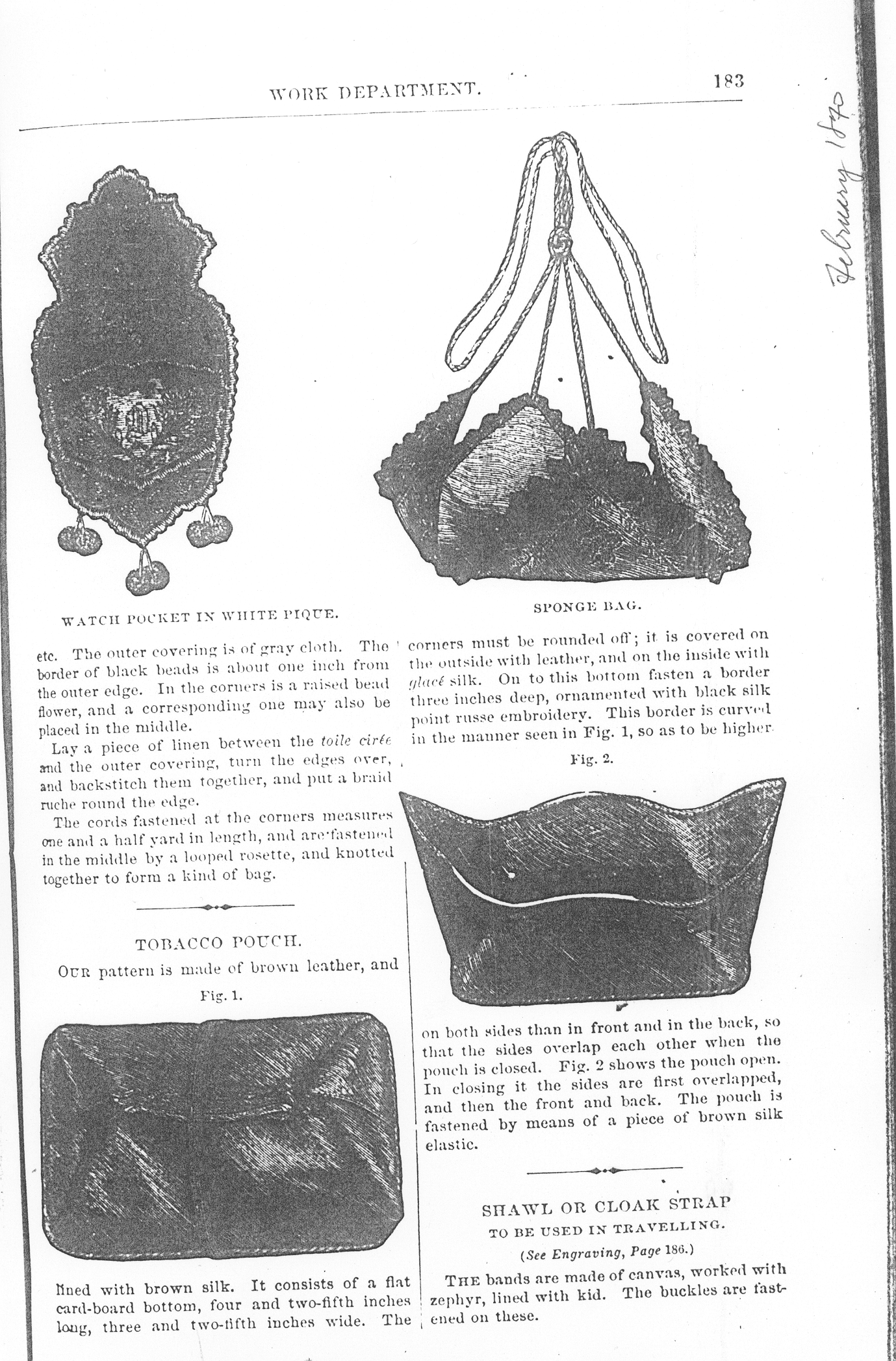

Beeton's needlework book shows many different styles of small purses and pouches made in a similar fashion to my pattern, but none indicate how they are to be lined. Same thing in Godey's and Peterson's (apparently they just assume that the reader will know how to finish the pouch.)
Now here's one particularly beautiful example, though, of a beaded tobacco pouch from the early 19th c.:
It's not clearly dated in the description, but it does look to be early 19th century. The owner explains that the red velvet lining was added later. (Red velvet doesn't seem to be appropriate for tobacco use, does it?)
All of the detailed descriptions of 19th century crocheted, embroidered, or knitted tobacco pouches I've found date from just after our period (1870s to 1890s). Most of those indicate that the pouch should be lined in kid leather.
