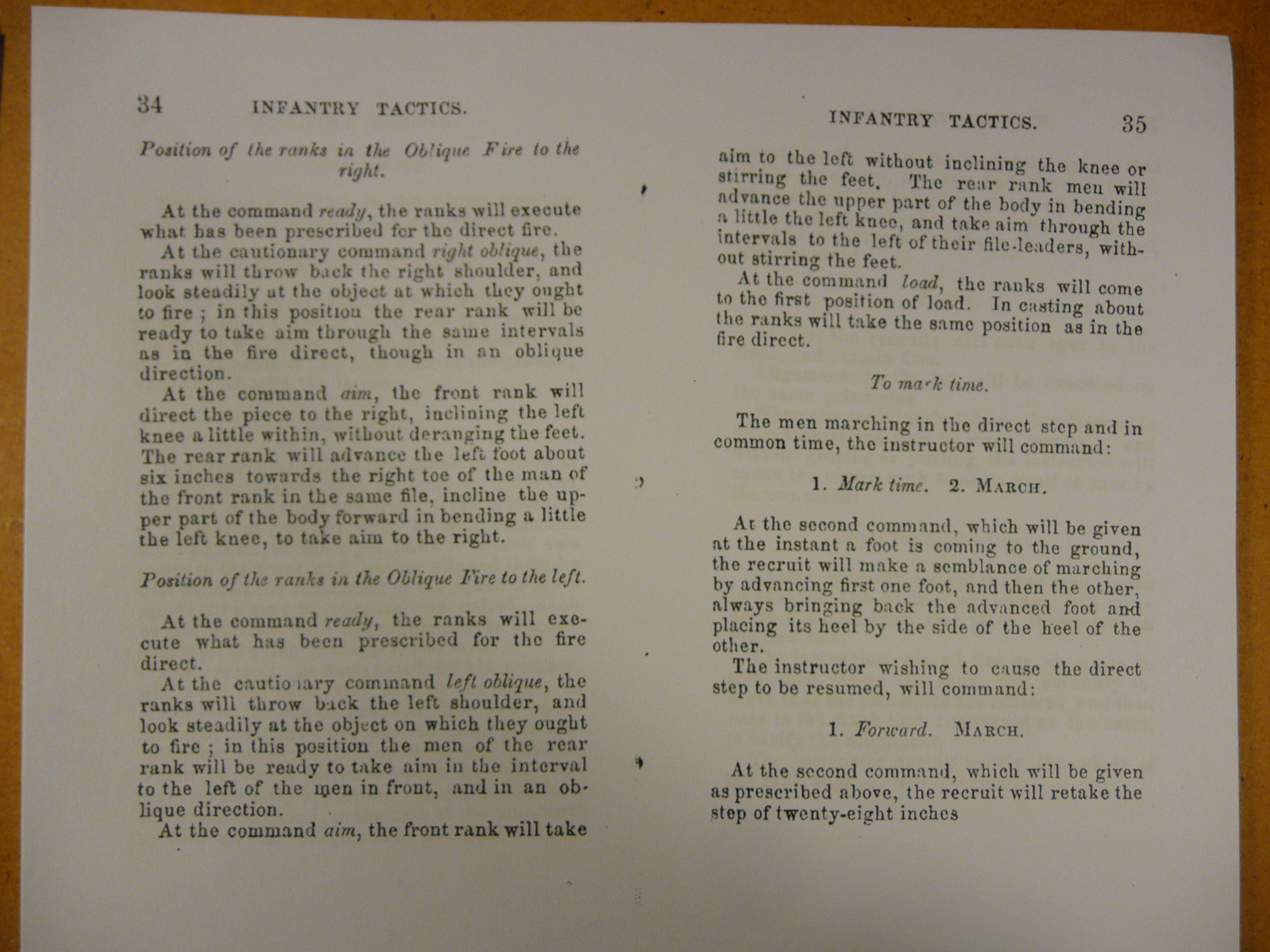

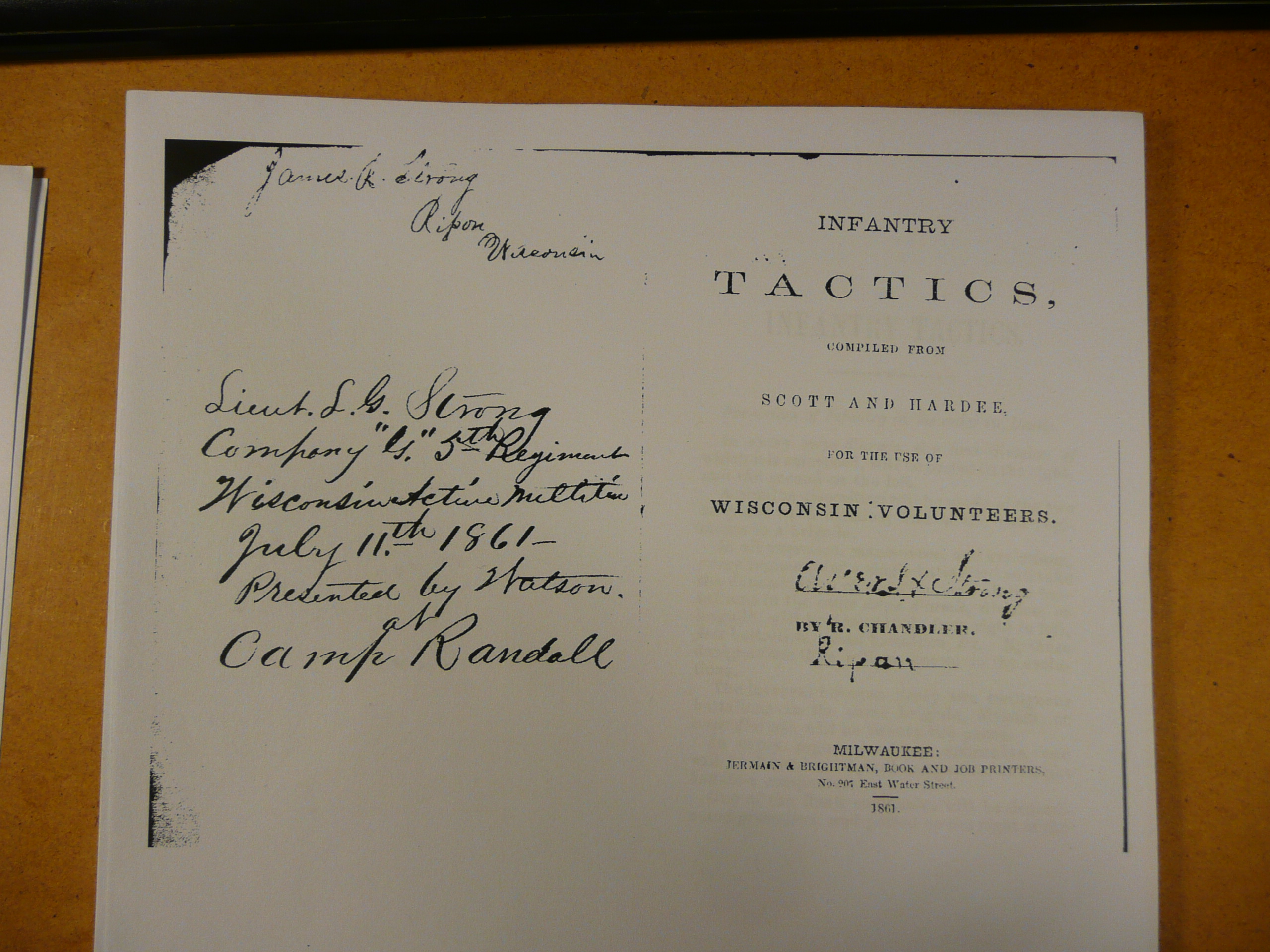

        Update:
        I Contact UNIVERSITY OF WISCONSIN-MADISON LIBRARIES about getting a scan of their book.
        And I got a reply that they were willing to scan it. But it would cost some 50USD.
        Since Iam a "poor" university student I went to our university library and asked them to get it for me. (since that is free)
        The first reply was that the Wisconsin library was not willing to scan it...
        The problem was that they have a max 50 pages rule, and it got 77 numbered pages. But I pointed out that the size is so small that they can scan two pages at a time and forwarded my mails.
        But my university library is not allowed to give me the PDF scan... so they send me a printed copy...
        Rather foolish when the owner or the book was willing to email me PDF.
        anyway. I now have a printed version. Two pages in the book only takes up half a a4 page, but I guess that is the original size.
        I will scan it later this week,

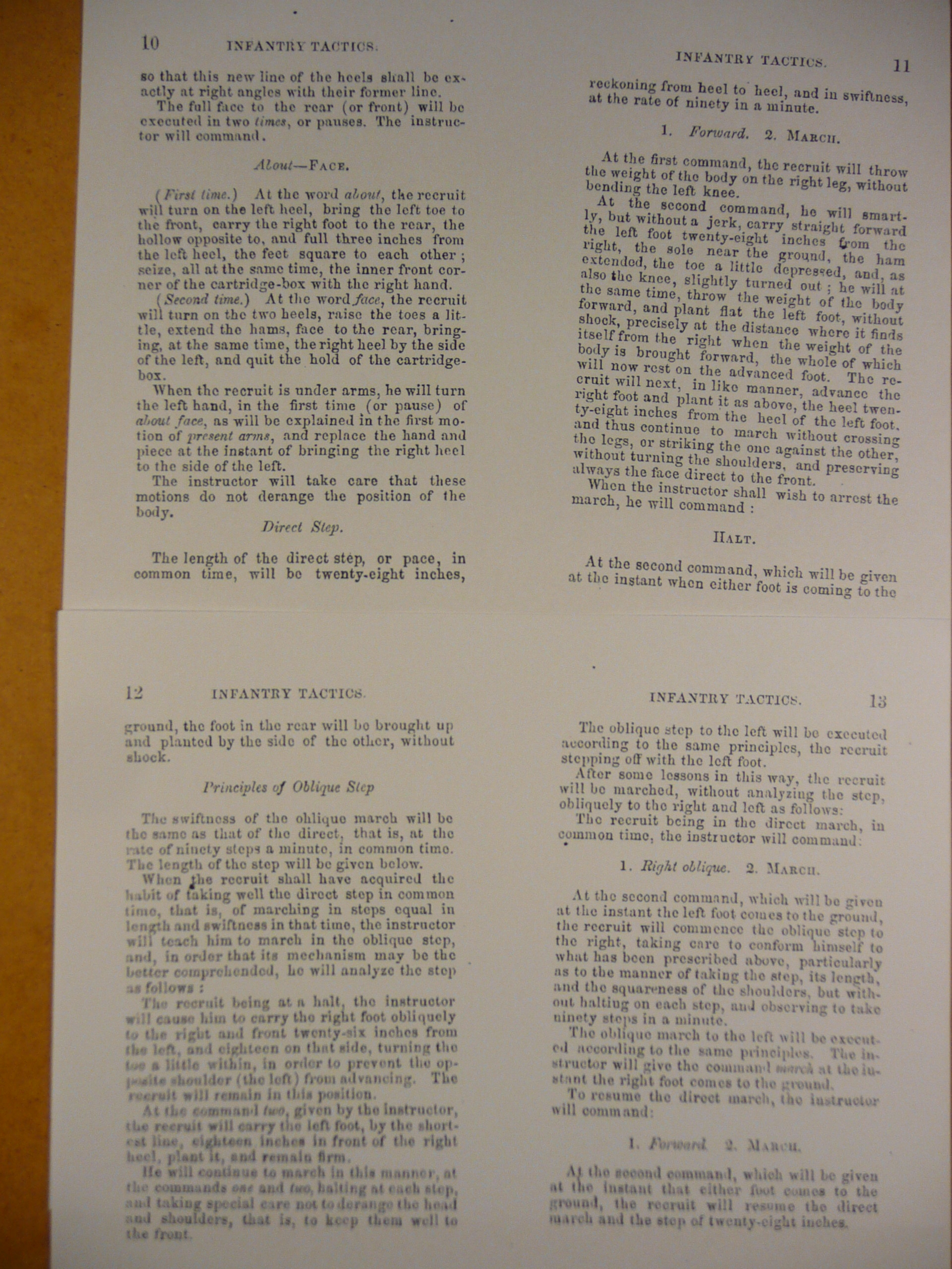

        But I took two pictures - the front page and the "left oblique firing" since this topic was mentioned and that is why I know about this book.
        Thomas Aagaard

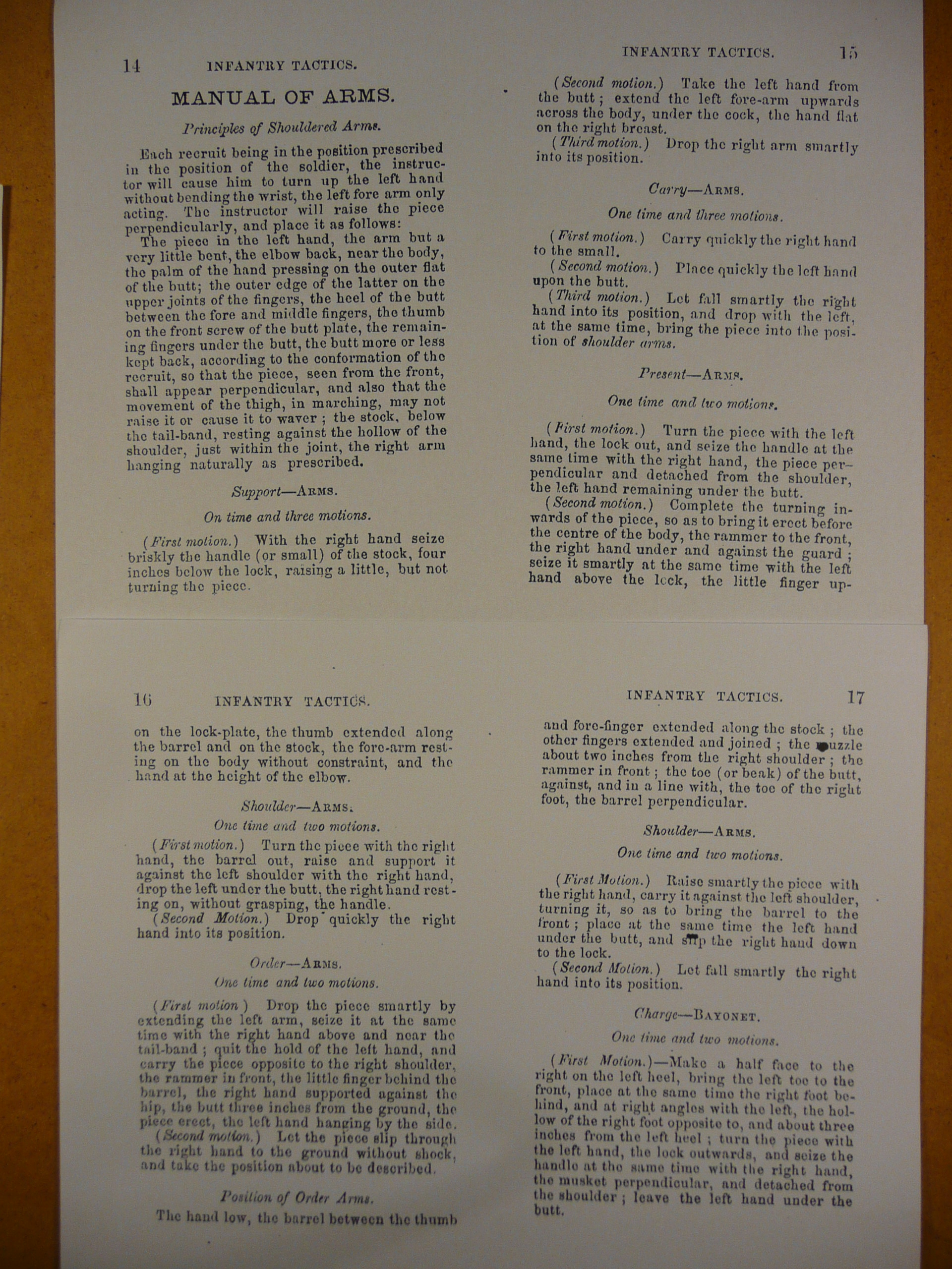

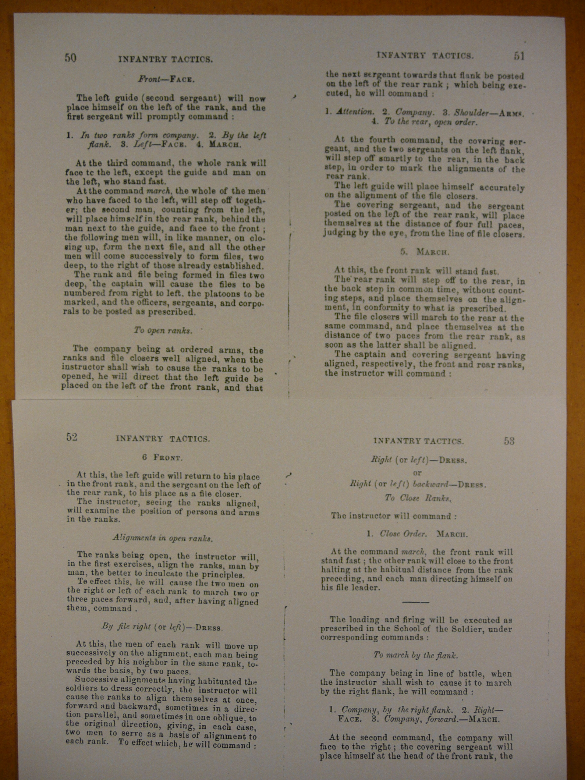

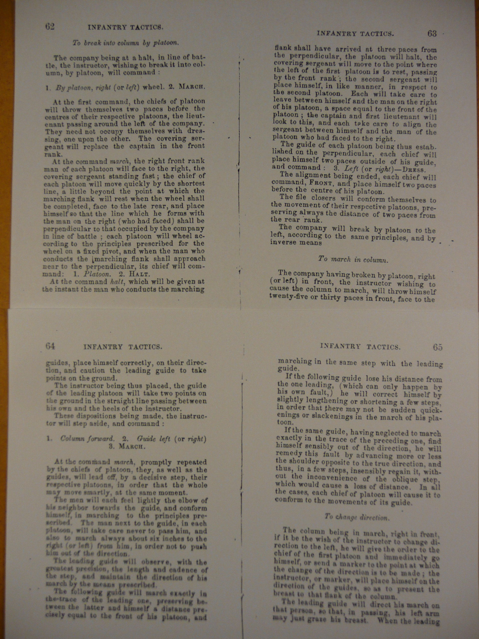

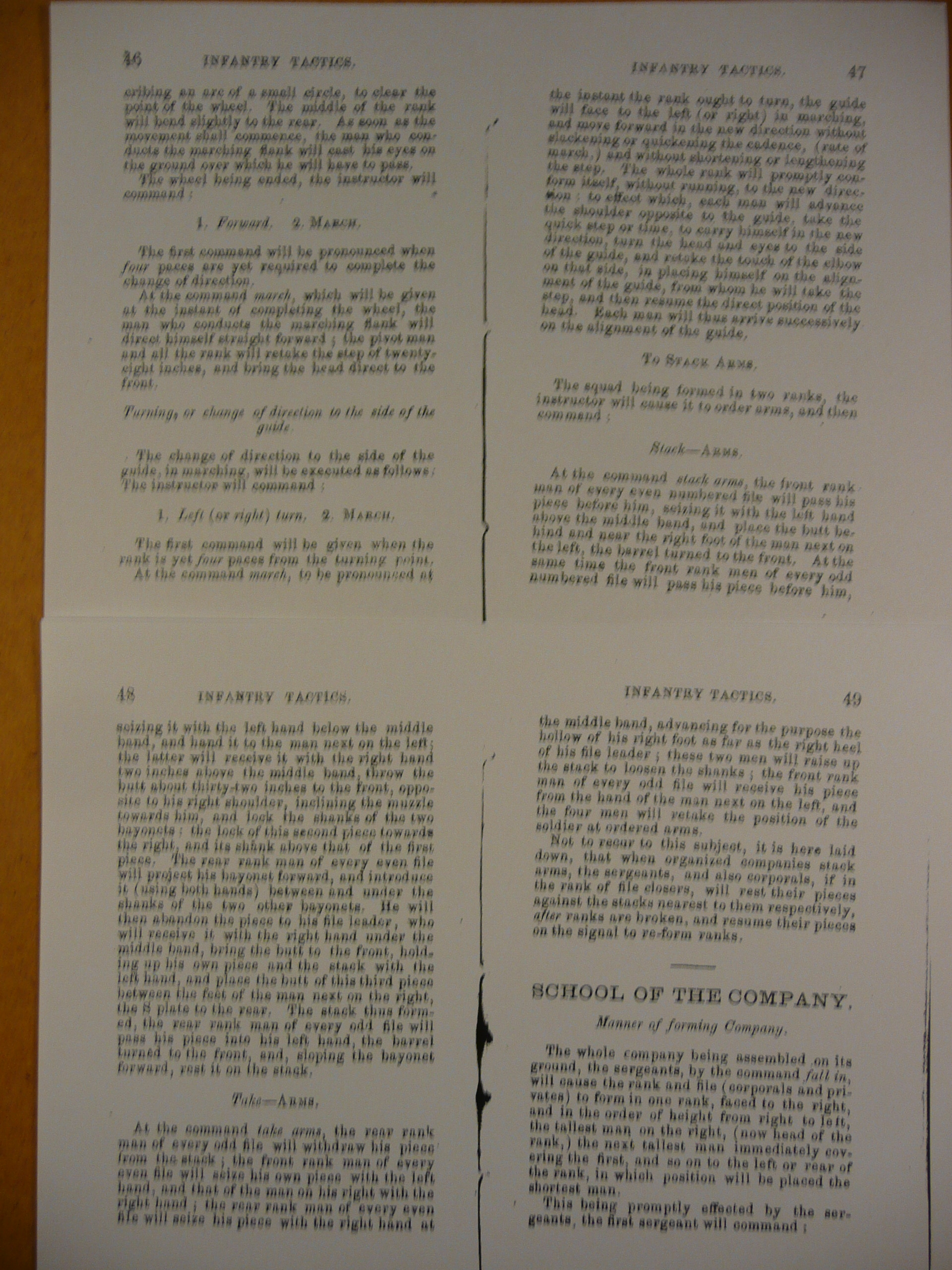

            Re: Looking for "Infantry tactics, compiled from Scott and Hardee for the use of Wisconsin volunteers" by Robert Chandler.

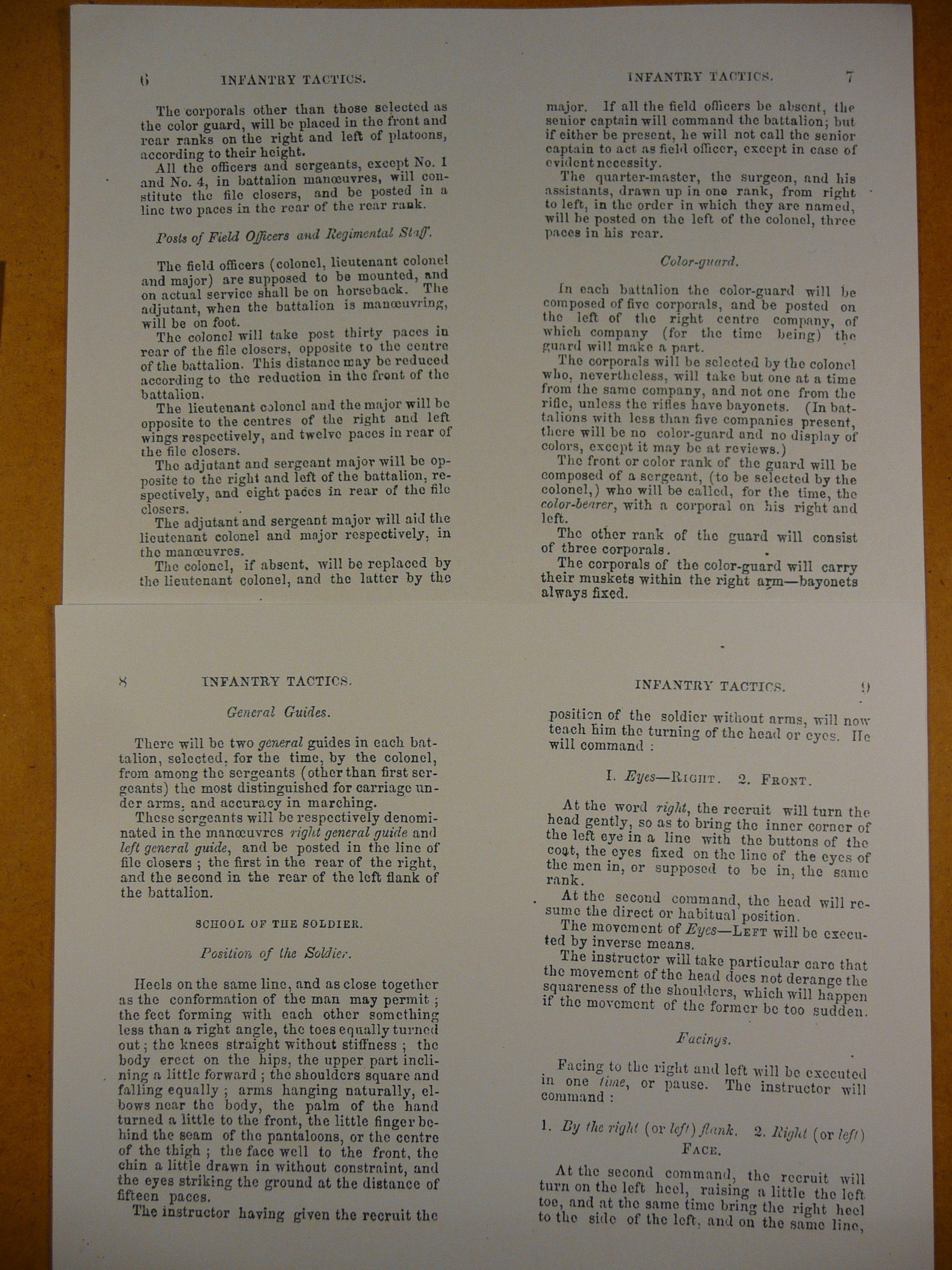

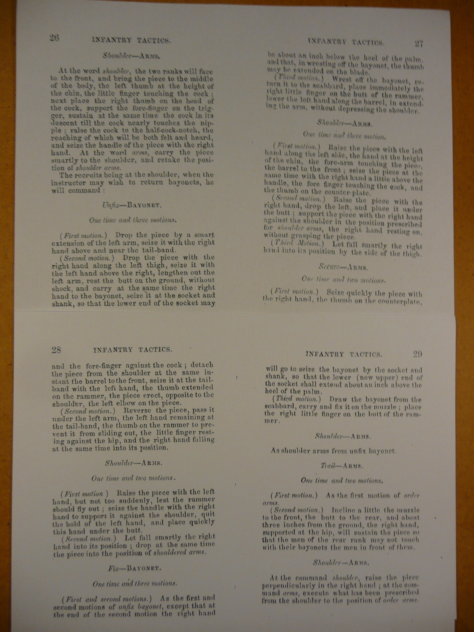

            I will still scan it properly and make it a pdf but I ended up taking pictures of each page with my camera.
            They can be found here.
            And as attachements to this post.
            I noticed that page 35-36 is in the wrong place when I took the pictures.
            The best way to view it is to copy all the pictures to you disk and then view them it full size. Makes it much easier to read the text

                There's something in here which really has my attention as it addresses one of my marching peaves : entire battalions marching by the flank across open fields.
                Too many reenactors don't review the school of the battalion. I understand enlisted men being wary about the higher levels of drill. However, the line and field grade officers really should understand the concepts. It's really not that difficult because is only about flanks, files and lines. One of those things in the manual which even some of the best drilled commanders don't utilize is the concept that the length of a battalion, marching by a flank, should never be longer than the front of the battalion when faced to the front.
                Here's how to visualize this. Imagine a battalion in line of battle and in two ranks. Picture the right and left extremes of the battalion. Now, face the battalion to the right (left). The length of the battalion facing to a flank - meaning the foremost and rearmost soldiers - should be within the same footprint - meaning the former right and left extreme - of the former front.
                The length will remain within the same footprint until the commander orders the battalion to march forward by that flank. In theory, there is plenty of room between the files because there should be about forty-eight inches between files with a regulation step of only twenty-eight inches. It just doesn't work that way in practice. The files at the front of the battalion will step off, but those behind them, not so much. Some not at all. This is how the line lengthens beyond the footprint of the battalion when it was faced to the front. It's like opening the bellows of an accordian. When a halt occurs, it takes a while for the rear of the battalion to make up that distance caused by those up front hesitating before marching by the flank. It's even worse when battalions march in two(!) ranks.
                Some stretch is going to happen when marching down a narrow lane or through some defile like a gate. No big deal. There are ways to close the opened bellows once the lane or defile has been passed. There's actually instruction in the tactics for dealing with defiles where only two or one soldier at a time can get through the defile, but I digress.
                When reenacting battalions march across an open fields, they generally march by the flank, despite there being no defile which dictates the width of the front. Reenacting battalions should march in column of companies across those wide open fields. Reasons that they march by the flank instead of by column include having passed through or the need to pass through some gate. Also, the men don't realize there is a simple method of going from column of companies into a battalion marching by the flank. They know how to form into companies from a battalion flank - by company into line - but not the other way around.
                A method is contained in Hardee's School of the Company, but it's not as easy to visualize as what is contained in page 61 of Chandler. He has a company, in column of platoons at full distance marching to the front, facing by the right (left) flank and then performing a by file left (right). Each platoon does this at the same time as the other. In theory, by the time the last file in the front platoon has wheeled left (right), the first file of the second platoon - which has already wheeled and marched forward - should be right there and ready to follow.
                This is kewl stuff which is almost never used by reenactors.
                It's not going to work that easily in practice. The second platoon may have some distance to overtake because it moved too slowly. More likely, the second platoon will have to briefly mark time while the last file of the first platoon finishes its wheel. No big deal. In a battalion context, you're generally going to see a column of companies, not a column of platoons.
                The text on page 61 of Chandler isn't really in Hardee. There, it's an individual company marching forward which faces right (left) and performs a by file left (right). (See para. 314 of the School of the Soldier in Hardee's Revised just down a tad from where this link goes : http://draytons.tripod.com/hardeesocosk.htm#co306 ) Para. 314 isn't as visual as a pair of platoons performing the manoeuver. Para. 325 does discuss this, but the concept isn't as clear as contained in Chandler.
                When a battalion marching across an open field is in column of companies, it takes less time to form into the desired battle formation. That small amount of time gained may be just the difference which makes or breaks a battle. Think about it and give it a try. It's not all that different from taking a battle line and ordering a by the right of companies to the front (rear) to pass through a mess like thick forest or an artillery battery. Once the mess is passed, the battle line is reformed by each company going into line.
                  Things I noticed when I looked it over:
                  Shoulder arms is done in the left hand but "Load" have the musket "butt shall rest upon the ground between the feet."
                  The first mention of the bayonet is the instruction of "charge bayonet" on page 17. Then "Unfix bayonet" on page 26 and fix bayonets come on page 28.
                  Clearly the general rule was to have the bayonet fixed all the time.
                  For comparison Casey have fix bayonets first.
                  It only have direct fire "fire by squad" and Oblique fire.
                  No fire by rank, fire by file. Loading kneeling or laying down.
                  But since it only have 75 pages for: Introduction with the structure of a regiment and company,(3-8) school of the soldier(8-49) and school of the company(49-77)... I guess something had to go.
                  There is no doubling when marching by the flank and the text suddenly mention a rear, center and front rank. The rest of the time it is clearly using two ranks, so I guess this is simply a mistake that the text about the center rank is not removed/changed.
