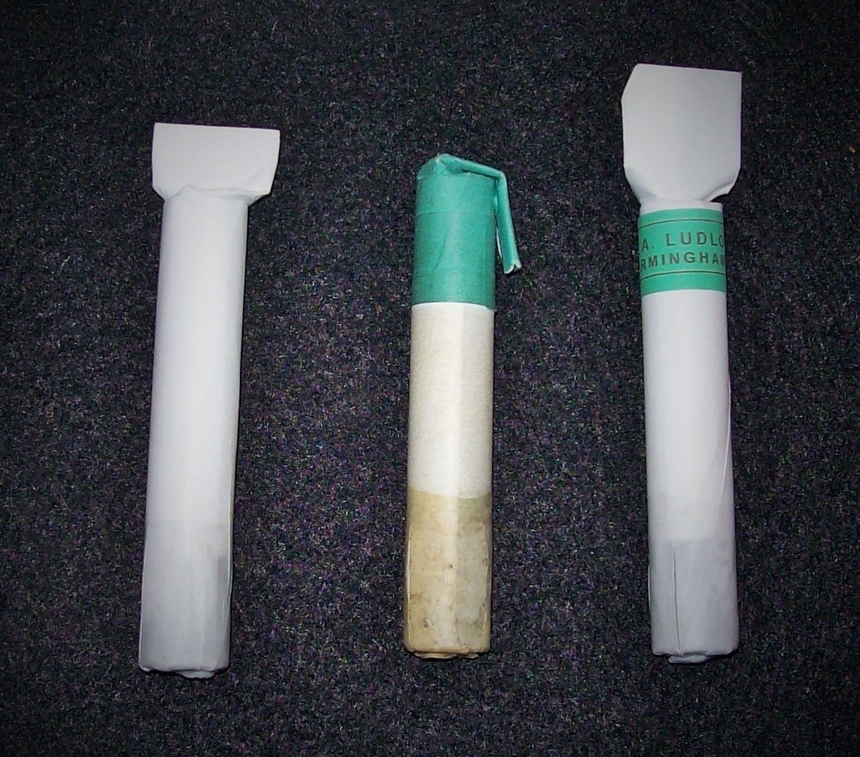

              As to the question of the DIFFERENCE between British and confederate...from the outside, I'd say not much. But, the bullets's mostly produced by the Confederate Arsenals the cavity base was mostly cone shaped, no wood, or clay plug, and .562" diameter was adopted, but many variances there too. Also the length of the confederate bullets varied considerably. The British imports were plug shaped, for use of a wood, or clay plug, sized .568", or a lot of times .550" diameter.
              I'd say that the quality control of the British was much more stringent than at the Confederate Arsenals. On the Confederate side, Mallet had uniformity issues that were numerous! Bullets badly cast, sizing dies wearing out, bullets too big, paper too thick, too thin, not always available, bullet weights/length varied from one cartridge to another, too much glue used in the cartridge formation, slits not cut in the cartridge...it's a wonder that they did as well as they did in their cartridge production!
              The picture is of 3 different Enfield Cartridge examples I have made. The left one is can either be a Early 3-paper British Enfield, or one produced by any one of the Confederate Arsenals. The middle one I copied from an original. I believe it's Confederate, the inner wrapper was green color, the outer wrapper is white, with a green color paper band to join the inner/outer wrappers together. I'm guessing it was due to paper availability? the right cartridge is a copy of a Ludlow Brothers 4-paper Enfield Cartridge imported from England.

                Nice cartridges, Kevin!
                Do you have a picture of the original Ludlow band laid out flat? Or, failing that, one of your reproductions? I would like to print some out on green paper and construct my own Ludlow bands.

                  Steve:
                  Hey, be glad to send you what I have, get me a PM, and I'll get you what I'm using for you own use. I have Confederate and British Enfield Arsenal Pack labels you can have also.
