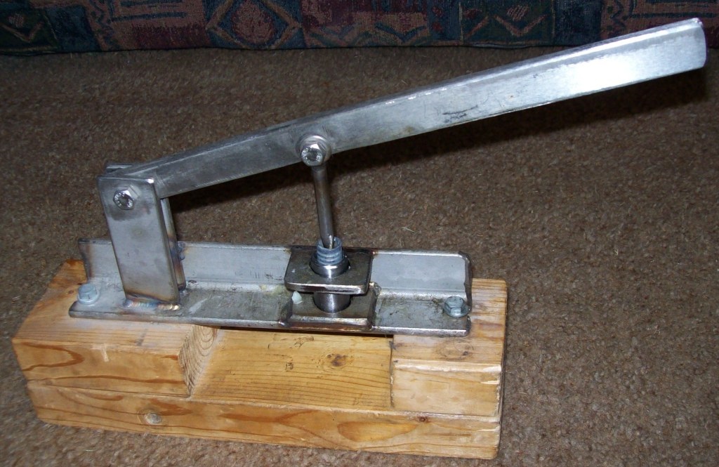

                      "I don't know how I'm going to size my Enfield cartridges. I have a Lyman Lubrisizer but it does not have a long enough stroke to put an entire cartridge through it. What kind of sizing equipment are you using?'
                      I have 3 sizing dies I got from the Rapine Mold company years back: .577", .578", and .580". Now, I needed a die made up for sizing bullets down to around .565" to make Enfield cartridges with. I found a 17/32" drill bit would drill a hole at .562", exactly what the confederate arsenals settled on. I had a machinist take that drill bit and bore me out a piece of round stock ,and ream it down to the size of my other rapine sizing dies. See the attachment photo.

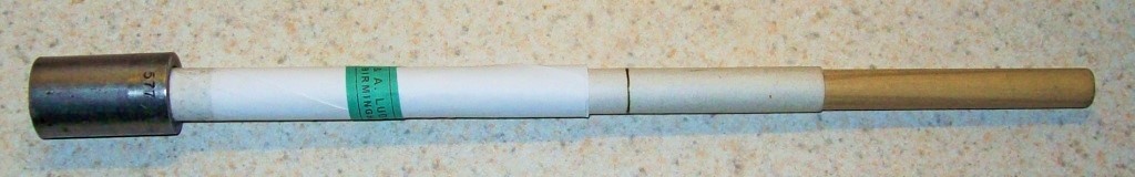

                        That looks useful for sizing the bullets, but what about completed cartridges? There does not appear to be enough room for the cartridge to exit out the bottom.
                        I'm guessing to size finished cartridges (or perhaps pre-charged cartridges) you would insert them into the die "paper end first", since the bullet's nose is pointed in that direction, and you could bear against the flat end of the cartridge (and bullet) to push it through the sizing die, paper and all.
                        I'm guessing it would make sense to lubricate the cartridge prior to sizing to help ease it through the die and to knock off excess lube and to make sure that if the paper swells any from absorbing lube that the entire shebang is sized to the proper finished size?

                          You figured it right, After lubing the bullet end of the cartridge, I stick the forming rod back into the cartridge, and press the bullet end only, down into the .577" sizing die, to true-up the lubed paper around the bullet. I made the mistake of trying to do this BEFORE lubing, and the bullet tore off the rest of the cartridge when I tried to take it back out! you can see how I keep the forming rod up against the bullet nose. After I pull the cartridge out, I then remove the forming rod carefully so I don't pull out the card-stock powder cylinder out with it! After that I take a razor knife and gently cut one, to three vertical slits around the bullet end, so when the bullet fires out of the barrel, the paper strips off the bullet.

                            That's interesting. I envisioned pushing the cartridge through the sizer open-end first, and pushing against the back of the bullet. I figured the shoulder of the bullet will ease the cartridge into the die, and any excess lube will be scraped towards the lube-end of the cartridge and not foul the rest of the cartridge body.
                            I will have to make a fixture to hold my sizing die as you did.
