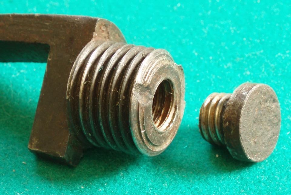

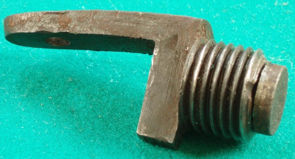

          From the time I asked the question until now, I've come across two other bits of information that I found interesting. The Belgian cone-in-barrel placement moved the flash hole forward 1/4 inch or so from the touch hole of the flint musket which meant that the flash from the cap may or may not hit the charge. To counter that, the Ordnance Department added an extension to the face of the original flint-configured plug so the percussion cap primer flash hit the base of the powder charge. See the attached pictures because I am probably not explaining this well. Also, Chris Warfel, who posts on this site, sent me a copy of a letter from Ripley to Ohio Adjutant General Buckingham dated 15 July 1861 in which Ripley apologizes for not having modern rifled muskets to send to Ohio. "These are altered muskets, and I regard them as in all respects, serviceable and efficient, and the prejudice against them are not founded on just grounds."
          It appears, though, that extending the breech did not always happen. Captain Kingsbury, the ordnance officer assigned to McClellan, wrote Ripley on 25 June 1861 reporting shoddy workmanship on (I think) the arsenal's part. "The mustering officers have informed me that the altered percussion muskets issued to the Ohio troops are inferior; that the work is generally badly done, the cone in some instances entering the barrel almost over the ball, and in others, near the extreme upper end of the powder."
ID:	225632Click image for larger version
