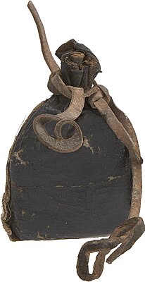

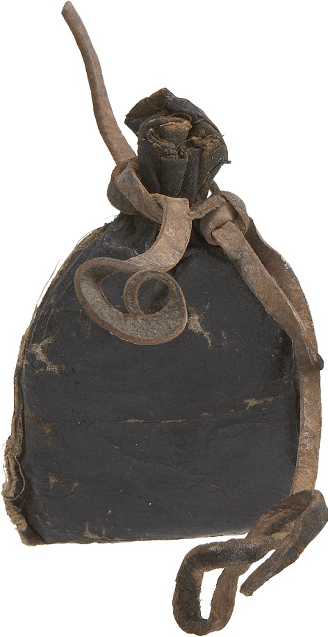

                Below you will find a detail from an original enameled "poke sack" that was featured in the John Henry Kurtz collection auction. It was sold with a container of Essence of Coffee (with both English and German instructions!), "substitute" for coffee, and Dr. Weaver's Worm Tea.
                The bag is enameled on the outside and closed with a strip of leather. if you look carefully, you'll see the side seam is actually on the outside of the bag and left raw, making the inside of the bag "smooth." Unfortunately I don't know the exact dimensions of the bag but compared to the worm tea container next to it (which I've cropped out), it's probably 4" tall by 3" wide. According to the auction catalog the bag is still filled with salt!
                Brian White

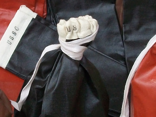

                          Here are some illistrations of what I understand you are asking about.
                          This is a USSC Ration bag with just the strings tightened. As you observed it can still spill its contents, especially fine items like sugar, ground coffee, or flour.
                          What I find works the best is to pull the draw strings tight then wrap them and tie them around the top of the bag like in the following photos.
                          They say a picture is worth a thousand words, probably more when translating between languages. I hope this helps some.
                          BTW Brian, Thanks for sharing the photo of the original painted cloth ration bag. I haven't seen it before.
