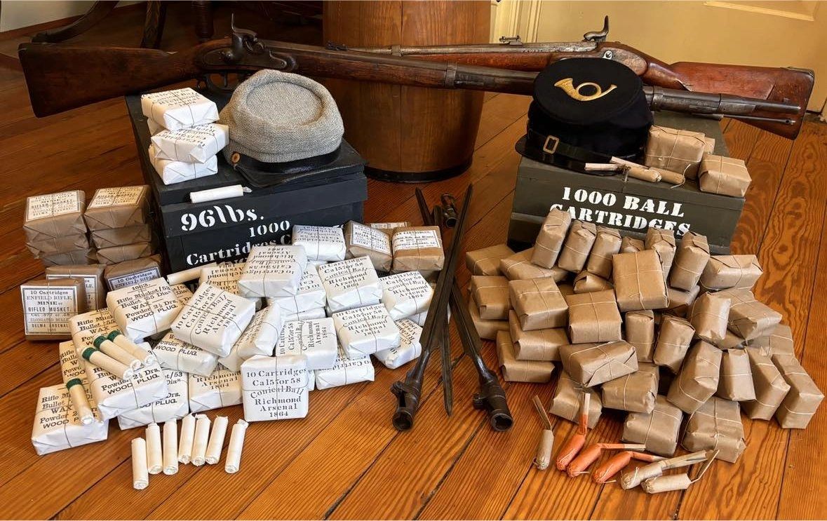

    This is a compilation of specifications and construction of cartridges, arsenal packs, and ammunition boxes per the Ordnance Manuals printed in 1841, 1850, and 1862.
    These manuals cover the Model 1816 series flintlock muskets, Common rifle, Hall's rifles and carbines, Model 1841 rifle, Model 1842 muskets and rifled muskets, Models 1855/1861/Richmond rifled muskets, musketoons, pistols, and Sharpe's carbines. Live rounds and blanks, buck and ball and Burton minie balls.
    Note that foreign weapons and ammo and domestic specialized ammo, like the Williams cleaner bullet, are not included. They may be added at later dates
    Please use it for your ammunition construction and storage needs.
