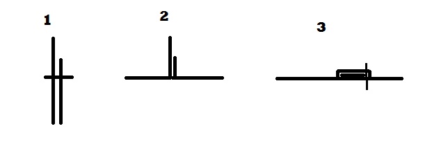

              Attached is a quick drawing of the method Wade described. Rather than having the edges of the cloth lined up, one edge is dropped 1/4" while the other is kept at 1/2" to 3/4". The seam is stitched and the longer seam allowance is simply turned under the shorter allowance and felled as usual. This eliminates having to trim 1/4" off of the "hidden" seam allowance if the edges of the cloth were flush.
              I've seen original shelter halves with the method here and also made with allowances interlocked/folded together. The former method shows only one line of stitching on the tent surface (felling) while the latter method shows both lines of stitching on both sides. Original tents also exhibit a wide variety of stitching length, thread type, finishing methods, etc. A contract Cincinnati tent* was machined with relatively thick 3-cord cotton thread while another Cincinnati tent made "in-house" is crudely sewn with cotton thread comparable to modern Size 3 crochet yarn. The hand-sewn Cincinnati tent is running stitched at 2-3 per inch while the overcast seam allowances and hems are about the same.

                  I was looking at my notes last night on the shelter tent owned by Alfred May, which I suspect is NOT the product of a Federal contract - but it is entirely handsewn, in a similar fashion to the Cincinnati Depot ones. I am pretty sure it was done as Brians drawings show - it is running stitched then the edges are whip stiched with big long stitches, yes, two or three to the inch. The corner reinforces have typically only nine stitches per edge!
                  However, my sketch may show something different than the photos. I'll see if Wade can get me the photos....as I am starting a copy of the May shelter tent....these photos might help your project too.

                    I have not gotten the photographs yet, but perhaps something better. The one who took the photos is the seamstress at our historic site, and when I explained why I wanted the images and described the seam, which looks the same on both sides, she told me it was possibly a "German felled seam". I tried this on a scrap of canvas with my heavy crochet thread and it gives the same result as the photos in Gaedes book. I was going to tell you to just google it up, but I tried that myself, and the only result was virtual cricket chirping.
                    To do this, lay your cloth together with one edge @1/4 or 3/8th from the other edge - use the selvedge for the longer part. If not, allow some part to fold back "on top" as you are looking at it. Whipstitch along the edge of the shorter part, and when done, fold the other edge back over and whipstitch its edge in a similar fashion.
                    In effect, you lay it together - assuming you have selvedge edges - just like Brians sketch, but you whipstitch the seams. If you don't have selvedges, you fold the raw edges back on top. Hope this makes sense. It goes pretty quickly, and doesn't pull apart nearly so badly as a running stitch on one side. All the stitching on the tent, except buttonholes and grommets, is done with this same whip stitch. If I had a camera I could post a "how to"...perhaps later...

                      Thank you for the information, this is really helpful! I was able to follow your directions just fine, and you are right, when my stitching isn't crappy it looks spot on to the examples. This was really helpful, thank you again David. If you do end up getting additional pictures, please send them my way. Amazing that, disregarding buttonholes and grommets, the whole tent is assembled with one stitch.
                      From the conclusions I had come to above, I was doing close to the same thing, whip stitching it on both sides, but was making things much more complicated than the simplicity of the German method you mention.

                        From looking at the photos, based on the samples I made, I don't think a running stitch was used on any of them. The bottom of the whip stitch looks like a running stitch - this is why I thought May's tent had a running stich - but no trial I made with a running stich looked right.
                        I too was working out a complicated way for some samples - maybe I would have figured it out - but this way is simple.
