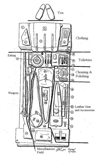

          I always liked this link on Syke's Regulars School of the Soldier page for blanket inspection; http://sykesregulars.org/instruction...inspection.php

              Mr. Siltman do you by chance have a copy of the picture. The pic is missing from the page. :(

                Yes I have copied it to my own files.

                  I have my doubts about the authenticity of the illustration from Sykes as I don't recall seeing text or an illustration like it. I do a lot of research related, speed reading in many documents so I'm willing to state that I could have missed it. However, can anyone show me a period source for any "junk on a bunk" diagram like the Sykes illustration? I like the idea, but it seems to be a modern concept which has been adopted to period methods. It sure doesn't conform to what I've seen in the U.S. Regulations : https://books.google.com/books?id=_G...page&q&f=false
                    I completely agree Silas, I've never come across anything remotely like that. And if I'm wearing my accoutrements and have just stacked arms......

                      To continue the discussion of the Sykes diagram for inspecting a soldier’s kit, it would be logical that it or something like it would appear in the regulations manuals of the Union and Confederate Armies, but nothing like will be found. In fact, the actual procedure for inspecting individual soldiers does not support the blanket display of Sykes diagram. For instance, it is inconceivable to believe that any assistant inspector-general is going to care one wit about the condition of a soldier’s tooth brush or whether he has a container of boot black in his kit, items that are included in the Sykes diagram. The inspectors were interested in the condition of a soldier’s public property – weapons, uniforms, accoutrements – not his mess gear. I have examined the inspector’s reports of many companies, which were a part of each muster roll form, and I have never seen any mention of the personal items mentioned above. Shortages of bayonets or shoes, yes. Indifferent uniforms, yes. A need for more razors, no.
                      When the procedures of inspections are reviewed one will see that they are the same for both armies. Let’s review those specific procedures outlined in the manuals as they relate to an individual soldier.
                      After a review of a regiment or battalion, the unit will be formed and the ranks opened. The Inspector will commence in front. After inspecting the dress and general appearance of the field and commissioned staff under arms, the Inspector, accompanied by these officers, will pass down the open column, looking at each rank front and rear.
                      As the Inspector successively approaches the companies, the captains will command: 1. Attention. 2. Company. 3. Inspection-Arms. The inspecting officer will then go through the whole company, and minutely inspect the arms, accoutrements and dress of each soldier. After this is done, the captain will command: Open-Boxes. The ammunition and the boxes will then be examined.
                      The Captain will then order the arms stacked, the ranks opened and the front rank to about face. The men will be ordered to unsling their knapsacks and then open them. The knapsacks will be placed at the feet of the men, the flaps from them, with the great coats on the flaps, and the knapsacks leaning on the great coats. In this position the Inspector will examine their contents, or so many of them as he may think necessary, commencing with the non-commissioned officers, the men standing at attention.
                      When the Inspector has passed through the company, the captain will command the knapsacks to be repacked. Once the knapsacks are repacked the men will resling them on their backs and the company will be ordered to return to their tents and quarters. The Inspector will then proceed to the hospital, magazine, arsenal, quarters, sutler’s shop, guard-house, and such other places as he may think proper to inspect.
                      Like Silas points out, it would be nice to have something like the Sykes diagram available, but absent any record of anything like it in the Army Regulations of either side, the proper thing to do would be to follow the process described in the manuals.

                        Re: Formal Inspection
                        [ATTACH=CONFIG]49439[/ATTACH]
                        Thanks for the pic! Just what I was looking for....... and it gives me ideas.
