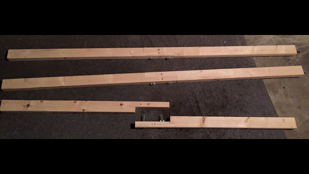

    I have a 9x9x7 A-Tent and need some assistance on making the poles. I know the ridge pole is usually cut so that it disassembles into two pieces for easier storage.
    I have three 2x4's that I need to cut but I am not sure of the specifics
    Can anyone offer information?

        Most other reenactors I know use poles that are made from 2x4's and look like these
Name:	A-Tent poleset.jpg

          When you say that you’re unsure of the specifics, I’m not sure if you mean the lengths you need to cut your poles or of making them “disassemble”.
          If it’s the length, lay out the tent on its side. Measure the length of the ridge (it may not be exactly 9’ due to shrinkage or what have you). That’s your ridge.
          Measure the height of the door (bottom to top of ridge) and subtract 3.5” (for your ridge 2x4) and that gives you the length for your uprights.
          I forget the size of the nail, but I used one about the same diameter as my pinky for the pins from the upright. Drill a hole slightly smaller than the nail in your upright, and slightly larger in your ridge. If your tent has grommets for the pins, make sure that you put the uprights in the correct position when drilling the holes and that your pins are long enough. Once you’re sure they’re in place, cut the nail head off with a dremmel or hacksaw and file the ends to remove any burrs.
          I’d personally set the tent up to make sure you’ve got the right dimensions before you start halving any of the lumber. It’s just easier, in my opinion. This lets you make any minor adjustments for good fit. When measuring, if in doubt, make it a little long as you an always cut a bit off if necessary.
          I also prefer the 45* cut and sleeve, such as Erik described over the bolt together type you showed in the photos. No bolts to lose, or to catch the canvas and tear. Plus it’s a stronger joint. I also use 2x2 for the lumber when possible.
          Hope that helps.
          Mike
            I like that idea also but can not find sheet metal in this area

              Blockade Runner will sell you the sheet metal ridge pole sleeve to fit a 2 by 4 with 4 bolts. I have some sleeves from them that are a good 25 years old--wood has failed in a storm but I've salvaged the sleeve and moved it on.
