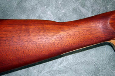

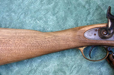

                            Well, lads, the famous "Katrina Gun" now has a new finish to its stock. (You may recall an earlier post that a friend bought this Armi Sport "Enfield" after it survived the Gulf hurricane a couple years ago -- the stock was completely bleached.)
                            Sorry that my photo seems a tad too red, but the color really isn't too bad and the finish is a big improvement over the rough, bare wood with which I started.
                            I spent several hours cleaning up the lock and interior parts (oops -- I loosened the screws just enough that I ended up with a pile of springs and sundry parts. Hope I got them all back in the right places!) from storm sludge, rust and yuck.
                            Rounding up the shopping list of chemicals needed for the job was a lot tougher than actually doing the work. If I had to do it again, I would have reshaped the stock a bit more and of course replaced or modified the lock plate and hammer. But this is to become a loaner musket so I concentrated on the finish.
                            I've included a photo of the materials I purchased, as well as before and after shots of part of the stock.
                            Hope that helps.
