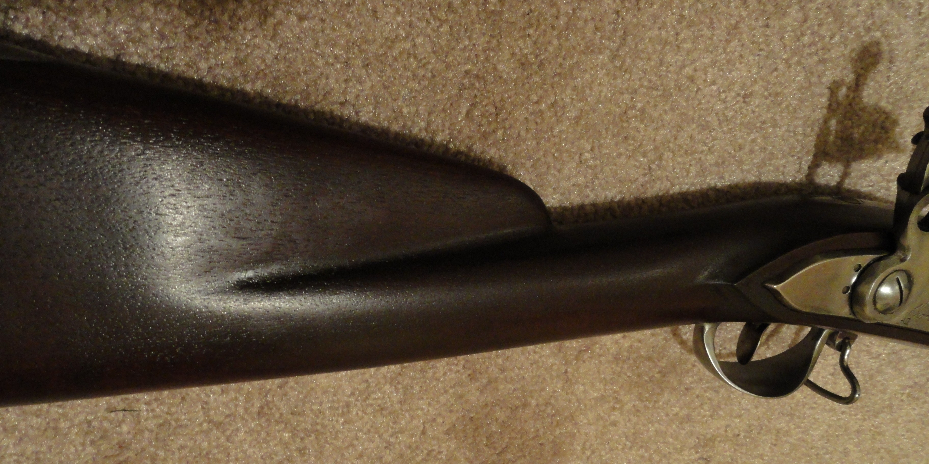

      I recently refinished an 1861 Springfield using this method. Thought I might share a few photos:
      There was an interesting blonde streak twisting through the wood and causing some difficulties but all in all I think It turned out well.
      Nathan Bruff

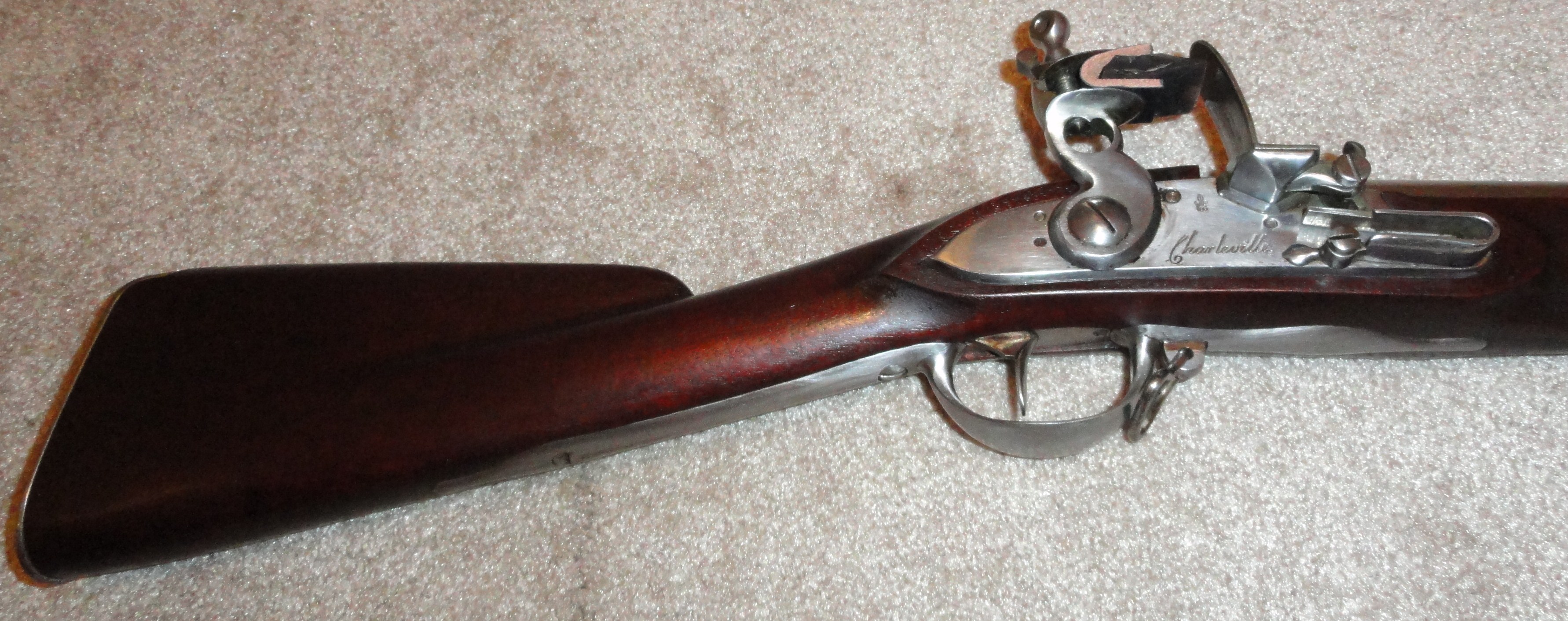

        Here's my shot at the 12-step program. This is a Miroku Charleville.
ID:	222419Click image for larger version
        I used Fiebing's dark brown leather dye and Laurel Mountain Forge permalyn stock finish.

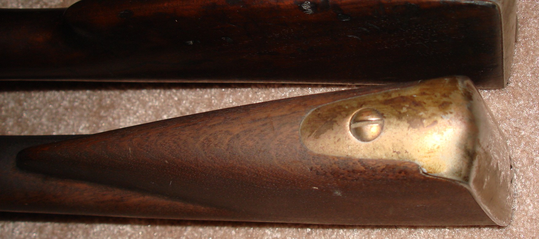

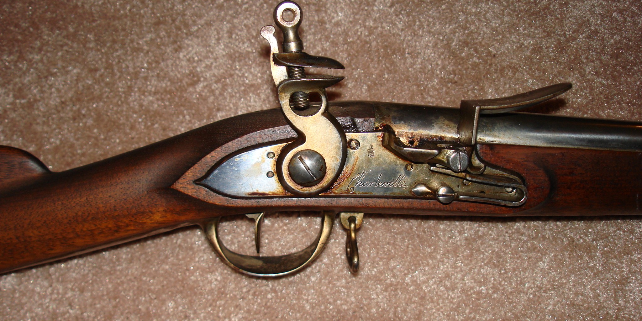

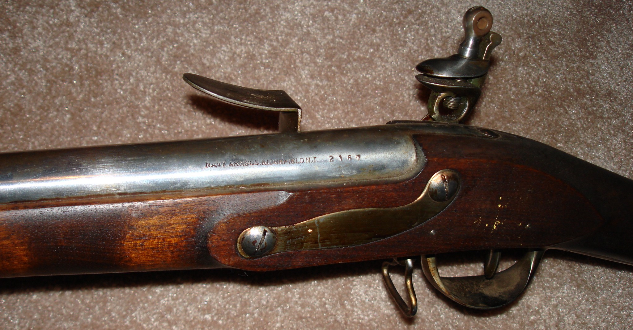

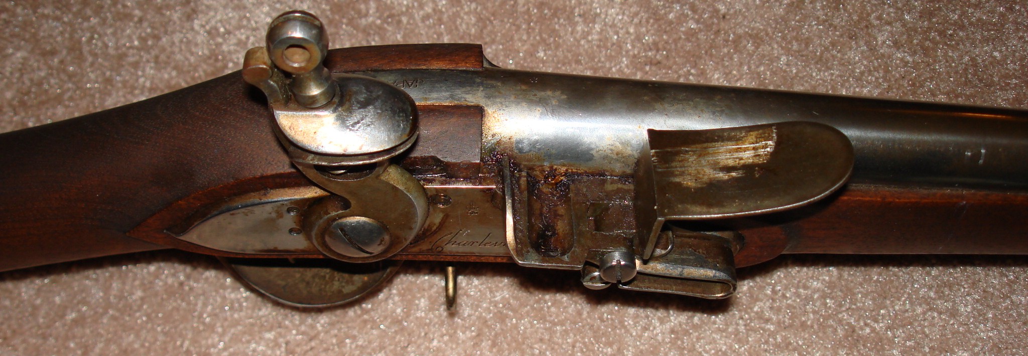

          Here are some before pics...
          (and that's not rust, that's super-old grease, cosmoline, or some other such crud... and it was a PAIN to clean off!!)

            I find the dark brown dye has a bit too much red coloring in it (see the above photos where a flash was used.) I have found it beneficial to mix black dye in with the dark brown to tone down this red color. Go easy on the black to begin with but basically mix up your dye and test it on the butt of the stock (under the butt plate) to see if you like the final shade. I've done about three muskets using this method this year (I'm blessed with the area's only leather store across the street from my post office) and plan to do another Richmond musket this week. Once I finish I will post a picture or two in this thread so you can see the effects of the dark brown/black mix.

              I agree on the red. I had plenty of warning from Curt on that point, but it seemed to lighten up a bit once I started applying the stock finish. "In the stain" (aka - stripped, stained, but pre-finish) the stock looked like a nice walnut color.
              What do you use for the black dye and where can you get it? Also, what proportion do you use?
              In anything you do, there's always a rookie effort... this was mine! At the end of the day, I'm still pleased with the results. Though a little red, the color is still a big improvement. There was an area of tighter grain just forward of the lock that, prior to refinishing, appeared as a dark spot. Refinishing evened that out and got rid of the funky yellowy tone that the wood had.

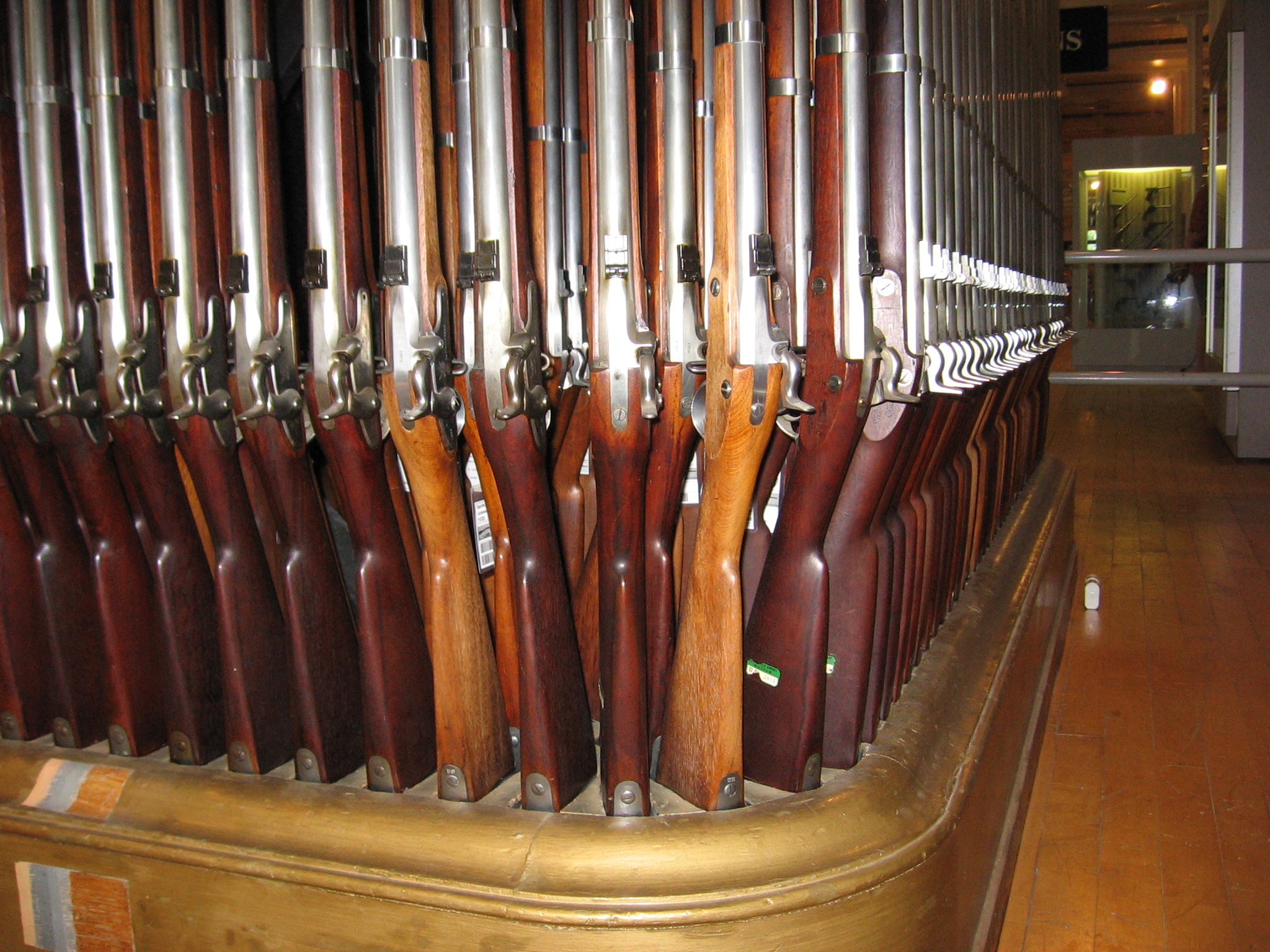

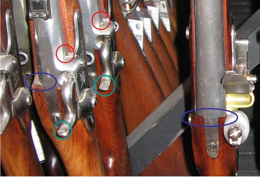

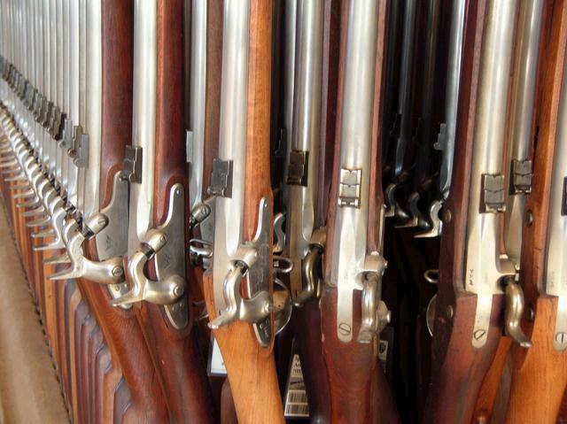

                            I thought these pics might be useful here:
Name:	1861 Details.JPG
ID:	222440Click image for larger version
Name:	Pipe Organ.jpg
ID:	222441Click image for larger version
                            These are shots of the "Pipe Organ" at SA NHS, showing details of wood and metal fit and finish on originals. This is also my "happy place". =)
