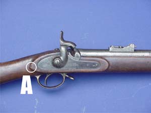

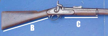

        I did a search of Enfield Stock discussions but found only info regarding stripping/staining/refinishing/weight of Enfield stocks. Most questions deal with metal or wood finish. My question has more to do with the line of the stock. That is, on repros the wooden parts just look wrong to me, yet I haven't noticed any discussions on this.
        Specifically I have attached two images.
        In "A" originals have a pronounced point in the lock area, whereas repros have a gradual curve.
        In "B" the heal of the stock curves in, whereas on repros actually curve out.
        In "C" the forearm is flat, whereas repos curve up just before the barrel band.
        If this is a repeated topic I appologize. Why isn't this addressed more? Also, when one sends his Enfield to be "defarbed" is this sort of thing taken care of, or is the owner usually responsible for this?

          Enfield stocks were finished by hand and exhibit variances in their forming of different parts. In this view an 1862 Tower two band and a Euro arms 2 band are compared. To me both areas "A" are equally pointed. Also there is a 2nd picture of another Tower which also appears to be pointy. The bigest fault I can find in this area are the sharp edges on the repros. This is very noticable on the euro arms. That feature plus about a half pound of extra wood makes them on the "clunkey" side. There are more glaring differences which you will probably run across the more you compare.

            Same two muskets. I am not sure what you ment about the curving. I am currently refinishing a Parker Hale and I think it's stock is much closer to an original than either armi-sport or euro arms. Not to mention that it is made out of the same kind of wood.

              Here is a better lock view of another enfield which was used by a soldier in the 9th Va. Inf.
              While you have your dremel tool out smooth out the wood by the tang as shown in the other picture.

                Jay,
                You've spotted some of the biggest problems with the repro Enfields.
                Jim, the Euroarms pics you posted look much different than most of the repros I've seen. Most do not have the point on the lock mortise, and don't have enough wood to create one similar to the originals. Additionally, most repro lock mortises are blended into the stock surrounding them, rather than having a 90 degree edge to them. Click here: http://www.trackofthewolf.com/(S(riw...83&styleID=291 and scroll down to see some pics of Euroarms muskets with partially shaped lock mortises.
                Quite a few repro Enfields have a curve in the stock just behind that first barrel band. It did not show up in those pics, though. Click here: http://www.taylorsfirearms.com/produ...WarMuskets.tpl and scroll down to the rifle-length Enfield to see the curved portion of the stock.

                  Yes, it can depend upon not only which repro Enfield one has, but also which "decade" or "era" of the repro and brand/maker one has.
                  And the "exact" details on original P1853 3rd Models vary by maker.
                  When working on various repro stocks, yes I personally "redefine" those features or elements as much as they can be reworked. However, I would say, IMHO, that when "copying an original" P1853 3rd Model, copy the features one has in front of you to the extent or degree that the version of the repro one is working on will allow. (Or one's Mental Image or Standards or Level of "Authenticity" in a repro the finished product requires..)
                  (I also like to thin down the forestock to give a more pronounced "step" to the barrel band locations... ;) )
                  To the best of my knowledge, such stock work is not part of the so-called "defarbing" work "package" the commercial services supply. However, I do know lads that do do the modifications for their own use and their pards', and some when they contract or agree to do the work for others..

                    I would say that you are dead-on with all three of your observations. I think that "A" and "B" are because the model of Enfield being reproduced is not the type used in the war. You will only find "C" on more recent Armi Sport arms. I'm not sure why they did it, but it looks more like the first or second (?) pattern stock for spring-retained barrel bands.
                    I was able to view a friend's defarbed Enfield recently. Whoever did the work, did a pretty good job on the stock.

                        The "curve" in the stock I mentioned before seems to me, on the dozen originals I have examined anyway, that it is concave. My EA actually curves out - looking very fat I might add.
                        I have thought of removing some of the weight by boring out some wood under the buttplate and a few places under the barrel on the forearm. Short of removing too much, what are the chances of weakening the wood?

                          Here are a couple of pictures comparing the euro to a PH I am refinishing and to an original. Notice the amount of wood under the mortise in the euro and the way the mortise extends all the way to the bottom of the stock in the PH and original.
                          I couldn't agree with you more about the two mysterious words. Although I usually say never say never when discussing a topic.
                          I am going to drag my friends armi-sport P-53 out and start checking that one.
