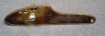

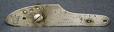

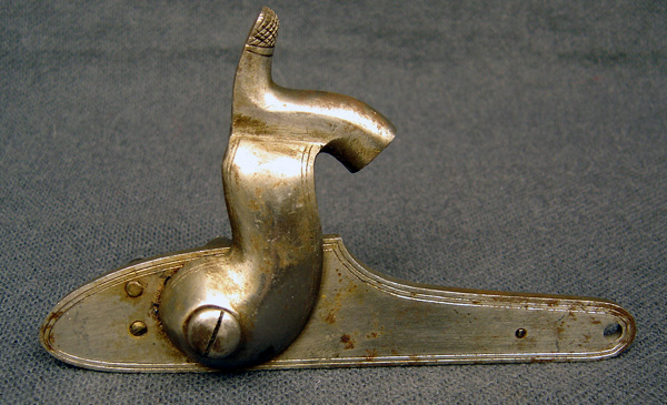

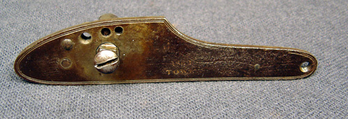

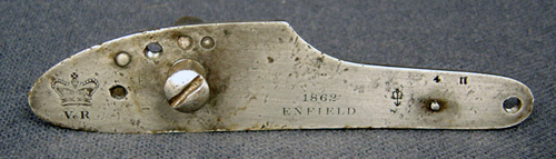

          Attached to give some images to the conversation are three pictures of original P-1853 lockplates in my current inventory.
          The first is a totally unmarked lock (on the outside) that has only the double line engraving (typically seen on Birmingham made locks) and nothing else. It has matching assembly numbers on the internal parts. I belive that it was made in Belgium on contract (likely for a Birmingham maker). It was left blank to be stamped as appropriate by the maker when used.
          The second is an RSAF produced lock, with all the appropriate British acceptance marks, etc. Note the "VR" under the Crown. There is no engraved, "double line" boarder.
          The third is a Joseph Bourne of Birmingham contract lock. The makers name is on the inside, and the outside is marked with only the Crown, TOWER and the date. As is typical of Birmingham locks, this one has the "double line" engraving.
