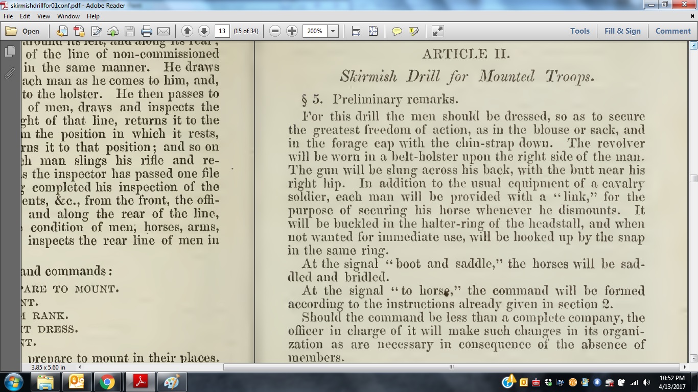

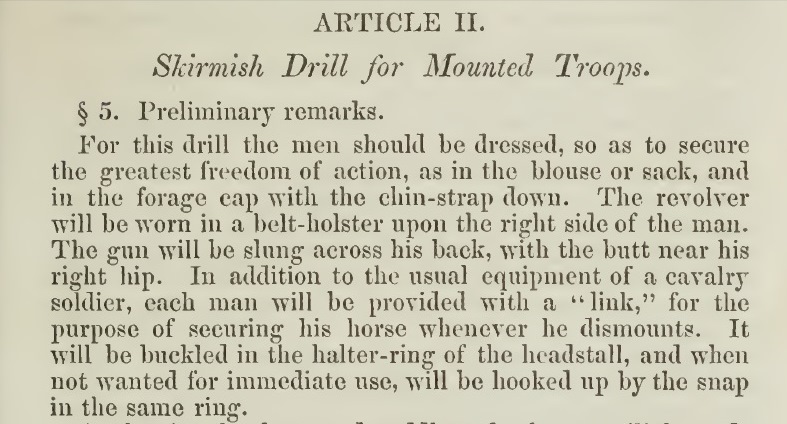

In Article II: Page 13, the manual states the following:
In addition to the usual equipment of a cavalry
soldier, each man will be provided with a "link," for the
purpose of securing his horse whenever he dismounts. It
will be buckled in the halter-ring of the headstall, and when
not wanted for immediate use, will be hooked up by the snap
in the same ring.

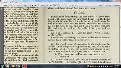

Additionally on page 11 it states:
To link after dismounting, the man stands to horse, faces
about to the rear, takes the link which hangs from the halter
ring of the horse
So, to answer our first question; our link straps should be secured to the halter ring from both ends when not employed.

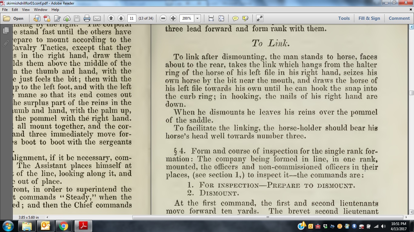

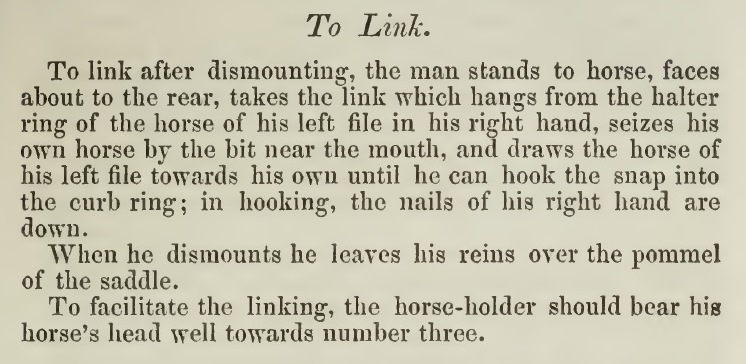

On that same page 11, it states the following procedure:
ring of the horse of his left file in his right hand, seizes his
own horse by the bit near the mouth, and draws the horse of
his left file towards his own until he can hook the snap into
the curb ring ; in hooking, the nails of his right hand are
down.....To facilitate the linking, the horse-holder should bear his
horse's head well towards number three.
This description completely changes the procedure for how our hobby traditionally links. Instead of #1 using his strap to link to #2, who uses his own to link to #3.....it is the exact opposite.
#1 should manipulate the strap from the #2 horse and move the #2 horse close to him and link to the curb ring. Then the #2 man reaches over to handle the #3 horse closer to him linking the #3 horse to his...not the other way around.
