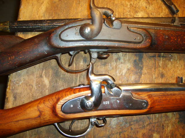

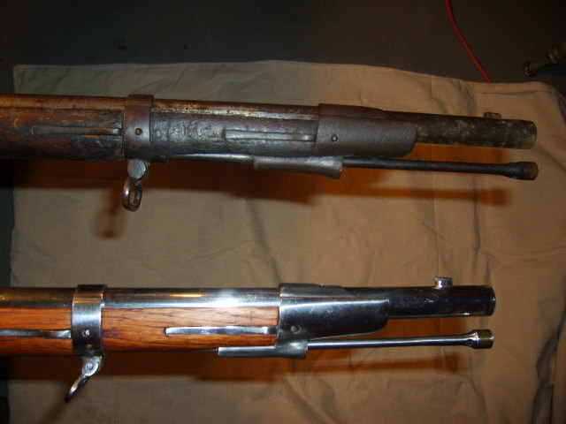

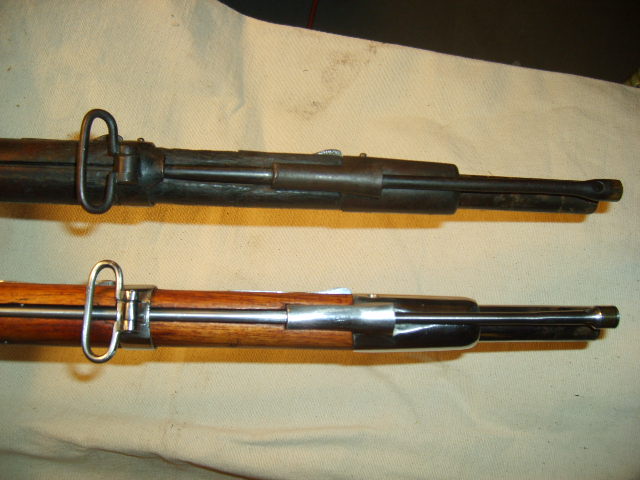

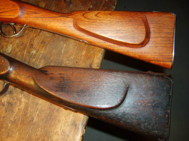

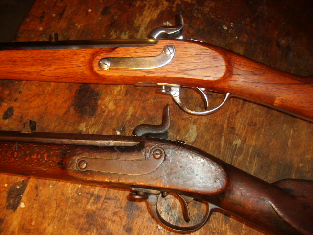

    Well, my Loyalist Arms Lorenz came today. I took a few quick photos of it next to my original Lorenz,so that others could see how it compares to at least one original.

              There are a few things I am not happy with,mainly the profile of the stock cheekpiece,but other than that, I am generally pleased with my Lorenz. Too bad the stock could not be that distinctive "speckled" wood that seems so common with Austrian arms of the period,but for now,it will do. The repo is about 1 inch longer overall than the original,but the distance between the front sight and the first barrel band is such that fitting an original bayonet is seemingly not possible,unless one was to move the front sight. The repo bayonets that I have for my Euroarms M61 and Enfield slide right on to the repo Lorenz barrel, but will take some grinding to the sight channel to fit. I have no idea how long Loyalist will take for a Lorenz bayonet, so in the meantime, I will modify a repo Springfield bayonet to fit.

                    An original Lorenz bayonet will not fit the repop Loyalist Arms; my beef is that if I do get a proprer rifled barrel I'll have to add a second bayonet... and an original at that. More $ that might be better used somewhere else. Best answer seems to be lining the barel to .54.

                      The pictures that were posted do not seem to show that big a difference between the placement of the sight and the first band. If the front site were to be moved forward a bit do you think an original bayonet would fit? I did notice the cheek piece was not as well defined as the original. Do you think that the repro stock could be sanded down like we have to do with the repro enfields to be a better match?

                        The problems with the Loyalist Arms repro stock won't be fixed by sanding. It is the dimension (length) of the wrist which throws off the placement of the cheek rest. This feature was a nice bit of human engineering on the original M-1854 Lorenz. The wrist portion of a gunstock can be extended easily enough by cutting back the comb, but not shortened again. Unfortunately, wood is easier removed than put back. The Loyalist Arms M-1854 Lorenz will require some "compromises" on the part of the end user, but not necessarily more than say that old warhorse the Euroarms P-53 Enfield, largely unchanged since the 1980s. The Lorenz details will just be harder to address, at least in the early production runs while LA bugs get ironed out.
                        I came to believe the reason for the coolness towards any repro Lorenz by Armi Sport or Euroarms was the fear of cannabalizing their existing Enfield sales, meaning potential Enfield buyers might be swayed by the Lorenz as an alternate rifle-musket choice, vs a smoothbore which is often an additional purchase for early war events. Just a possible theory. The price of the Loyalist Arms M-1854 is attractive, at least initially. The type corrections needed will push the price upwards for the purchaser, unless you can tolerate the details as they are. One potential upside is if there turns out to be a good sized market for the M-1854 Lorenz, the other repro gunmakers may respond with an "improved" product. Let's not hold our breath, though.
                        Another possibility is the bayonet lug was mis-placed to promote easier fitting of existing repro bayonets vs waiting for a new Lorenz bayonet to be produced. Loyalist Arms is famously slow about getting around to tooling up for these sorts of details. I would have been surprised if an original Lorenz bayonet would fit due to the larger .62 barrel.
